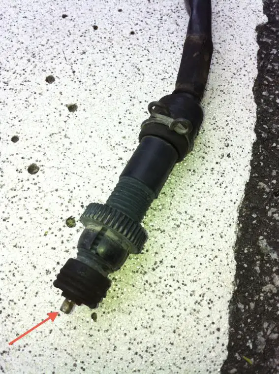

Think its about rear stop switch corrosion issue, hence they'll just replace the switch? Corrct me if i'm wrong.
Anyway, its a small matter, not a major life threathening defect.

This is the part that may be faulty. The connector may be corroded resulting in brake lights not being activated when applying rear brakes. They will check the part for corrosion. Whether or not they replace the part or just clean/repair the part depends on the level of corrosion.
Mine was replaced.
Be wary of the source of information for your bike's maintenance. Some FAQs are compiled by people who lack the technical know how. :angel:
Mine was replaced.
[ATTACH=CONFIG]274206[/ATTACH]
Did u leave ur bike there? How long is the process?
I waited for them to finish. 2 hours inclusive of lunch hour.
