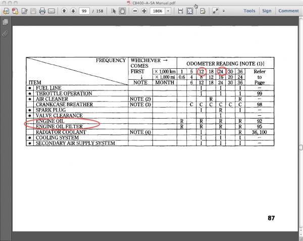

"Honda has been the world's largest motorcycle manufacturer since 1959, as well as the world's largest manufacturer of internal combustion engines measured by volume, producing more than 14 million internal combustion engines each year."
http://en.wikipedia.org/wiki/Honda
Being the world's largest motorcycle manufacturer, surely Honda knows a thing or two about "engine heat and breakdown of lubricant viscosity" in motorcycles. Now, why would Honda recommend 12,000km oil change intervals? :lol: :lol: :lol:
Be wary of the source of information for your bike's maintenance. Some FAQs are compiled by people who lack the technical know how. :angel:
I have a friend who rode a S4 VerS for many years, no problem, and he changes his oil every 10,000km. I believe that the need to frequently change oil, as often as 3000km as recommended by some mechanics, is their way of generating more sales and profit. With a good fully synthetic oil coupled with a good oil filter (our bikes have, but some other bikes doesnt have engine oil filter), I believe that Honda is accurate in its service interval recommendations (i.e. 12000km).
Honda would not put that figure down, and risk having their bikes suffering mechanical problem - that would become not only a legal issue for them (as it's official manual recommendation from manufacturer) but also a PR nightmare.
Spot on! These mechs just want to sell their service packages to make more money for themselves. It's easy for them to do it because they play on unsuspecting bike owners' emotions. Putting emotions aside, the fact remains that Honda is a reputable manufacturer and as you have rightly said, would not risk any PR nightmares by recommending an unsustainable oil change interval.
So, please stop changing your engine oils at 3000 or 5000km. Stop advising people to change at those low intervals. Not only are you wasting money, you are wasting one of the planet's most limited supplies.

Agree. Last paragraph should be "sticky" note advice in this forum. Trust the manual. Collectively we could reduce wastage.
