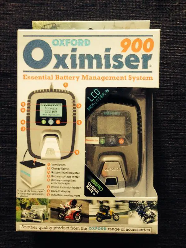

Oxford Oximiser 900 any kind of bike battery charger. Still new 10/10 with box and manual. Any best price will get. Msg/watsapp me at 98507961. No PM required. Serious buyer only.
