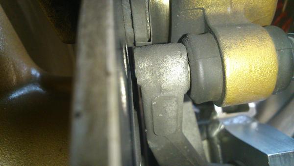

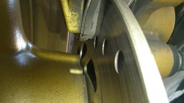

hi guys. how much km can the stock brake pads last for our bikes? especially the rear one. went to change EO and the mechanic said my rear brake pad going to finish. i am abit noob in this. thanks.

I think can still last another oil change or 2
Should get it changed as soon as possible to avoid scratching your disc. =D
