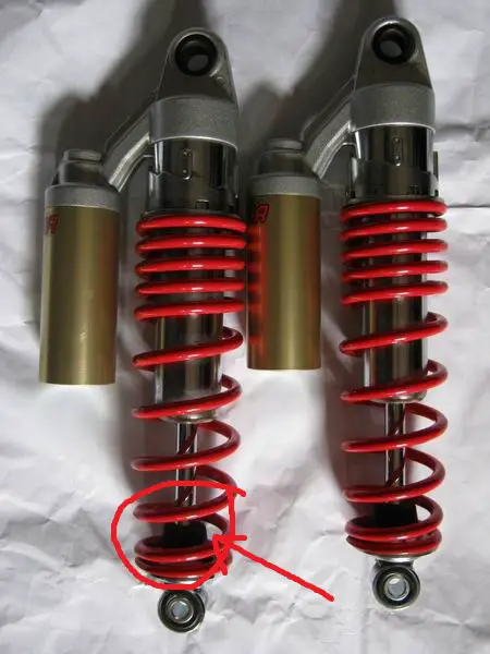

that's the bump stop. and yes, most shops will change it when doing shock servicing.
