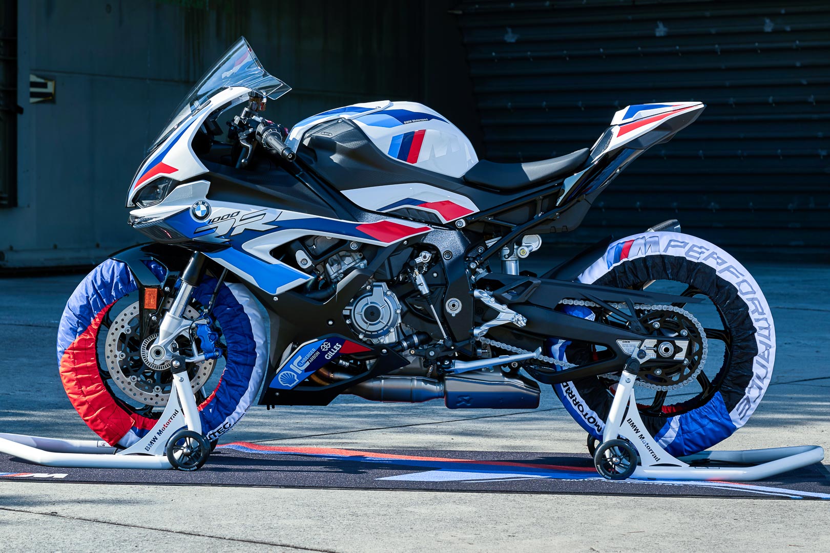

The standard BMW S 1000 RR, which has been around since it emerged in 2009 as a Superbike World Championship contender, uses a water-cooled 999-cc inline four-cylinder engine producing 205 horsepower with a redline at 14,600 rpm and a top speed of 185 mph. A solid foundation, then. Now, the M 1000 RR (or M RR for short) makes 212 hp at 14,500 rpm and has a higher redline at 15,100 rpm thanks to a bunch of internal upgrades.
On the list are lighter two-ring forged pistons, titanium con rods, machined intake ports and lighter, slimmer rocker arms, while a titanium exhaust system opens things up and saves nearly 7.5 pounds of weight. Beyond the engine, the M division also gave the M RR carbon fiber winglets and a unique windscreen that generate up to 35.9 pounds of downforce at 189 mph. The bike's swing-arm is lighter than the S 1000 RR, giving it a slightly longer wheelbase, and special M-specific suspension tuning takes things even further. Stopping the bike's M carbon fiber wheels are four-piston twin-disc M brakes in the front and a two-piston single disc in the rear. We'll go into more details on the individual components later on.
BMW says these changes have been developed for sport racings and "perfected for the road." That means this race-focused bike features daily rider comforts like heated grips, hill-start control, and ABS Pro settings for rain, road, with a dynamic mode.
The M1000RR is BMW’s equivalent to Ducati’s Panigale V4R – a homologation special, designed to meet FIM WSBK and Superstock rules offering increased performance and race-tuning potential compared to the normal S1000RR. It’s built around a revised version of the S1000RR’s Shiftcam inline four, now rated at 209bhp (212PS, 156kW) in road-legal form, plus race-inspired weight loss, suspension and aerodynamics to create a package that comes in at a mere 192kg ready-to-ride. In short it’s the most potent street-legal production bike BMW has ever made, and one that gives the firm the best chance yet of getting the racing success that’s eluded the firm in the decade since the S1000RR was launched.

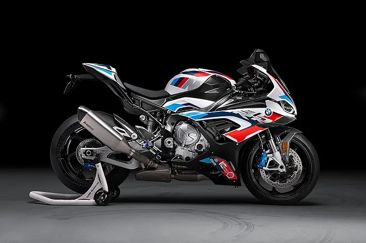

Like the S1000RR, the M1000RR has variable-length intake trumpets, but they’re shorter than before to improve top-end performance. A new Akrapovic titanium exhaust system cuts a remarkable 3657g from the weight of the stock pipe, totalling just 7780g.

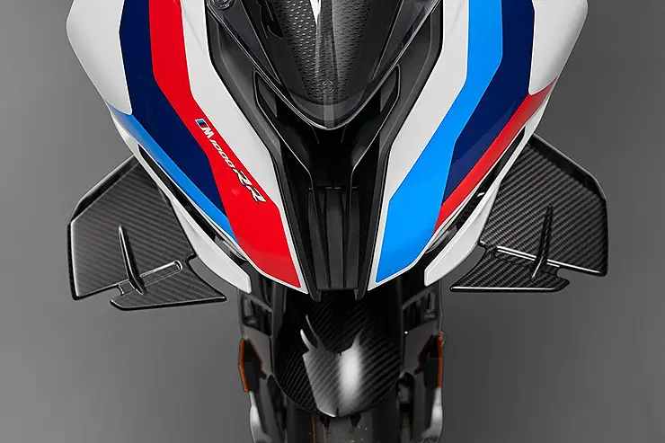

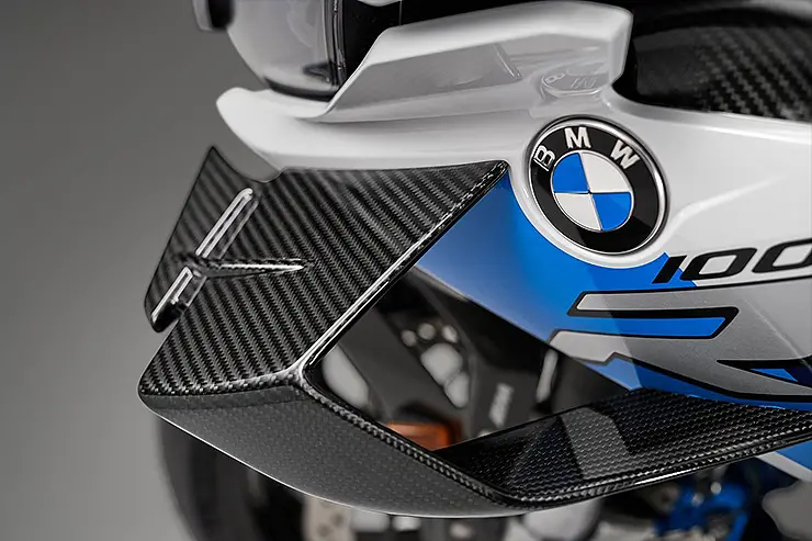

The engine changes might be significant, but the M1000RR’s aero updates are more noticeable. Like an increasing number of its rivals, the BMW has grown wings.
While we’ve recently seen BMW developing advanced active aerodynamics, its first production foray into the field is with conventional fixed-position winglets on either side of the nose. Designed to help keep the front of the bike down during acceleration, allowing the rider to use more throttle without wheelying, the BMW winglets are intricately-designed carbon-fibre parts that are claimed to create as much as 13.4kg of downforce at 186mph.
The M1000RR also gets a new, taller windscreen that BMW claims reduces wind resistance and offsets the extra drag of the winglets so top speed isn’t reduced.
BMW says that during tests with Tom Sykes and Eugene Laverty, the M1000RR was 0.5s to 0.7s per lap faster with the winglets fitted than without. Speaking of lap times, the firm says that BMW World Endurance rider Markus Reiterberger, on a stock M1000RR fitted with slicks, was just 2.101s slower than Tom Sykes and 1.590s slower than Eugene Laverty when they were riding full WSB-spec machines that were 15hp more powerful and 15kg lighter.

At 192kg, the bike’s weight is 5kg less than the normal S1000RR, largely accounted for by the 3.7kg lighter exhaust system. The wheels – BMW’s ‘M’ carbon rims – are also 1.7kg lighter than the normal aluminium ones.
Other chassis tweaks include milled alloy triple clamps and revised rear suspension geometry that increases the rear ride height by 6mm. It’s all slowed down by new ‘M’ brakes developed with Nissin with lighter calipers and thicker discs than the stock S1000RR.

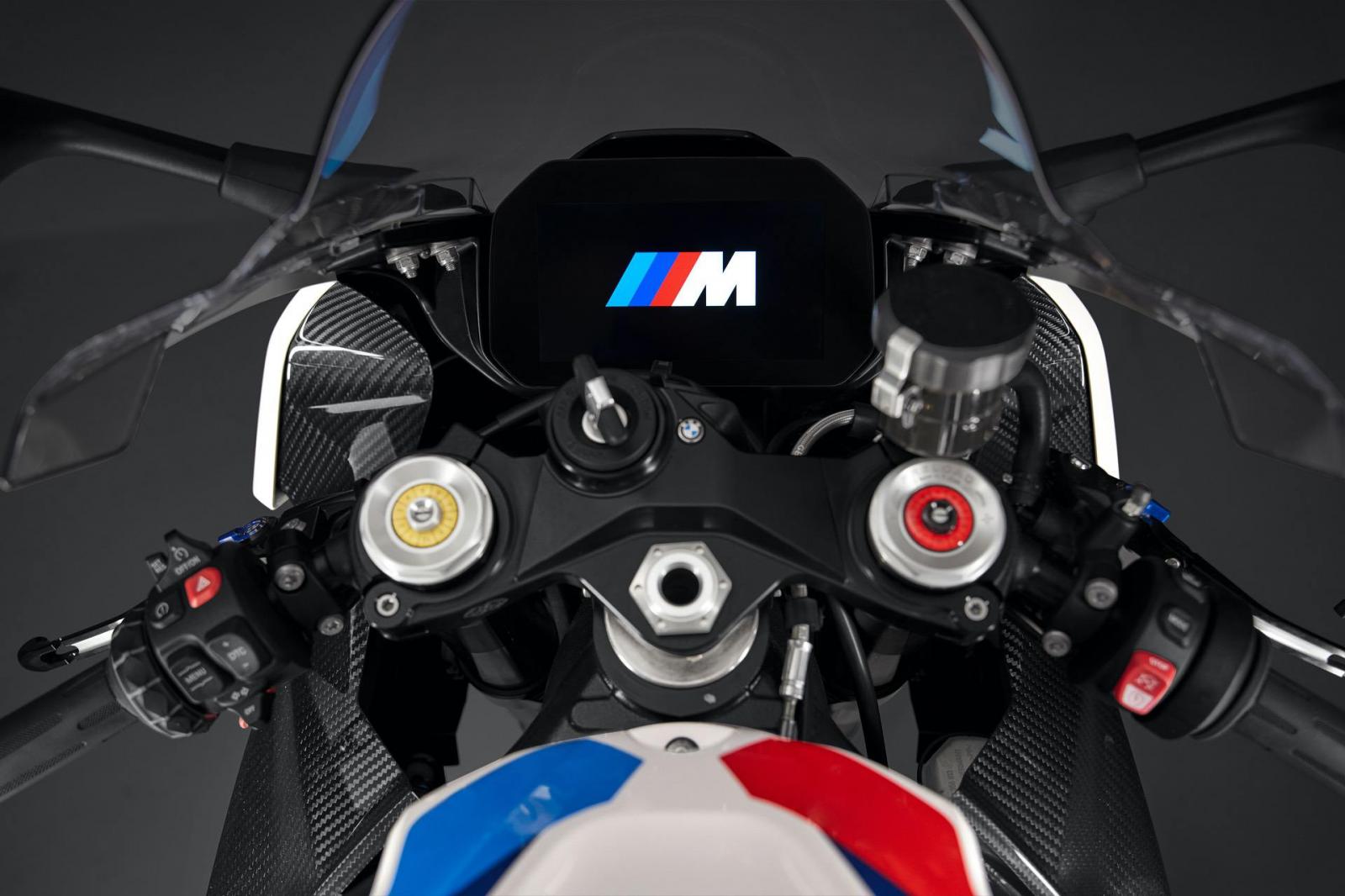

While the bike’s on-board view is largely familiar the TFT dash gets customised displays for the M1000RR, and if you splash out an extra £4100 for the ‘M Competition Package’ you get an activation code that allows comprehensive data logging to be downloaded via the bike’s OBD port.
That M Competition Package also brings the software for a GPS lap timer trigger and an array of milled alloy parts including levers and footrests, the ‘M’ carbon package and a 220g lighter swingarm as well as the firm’s newly-released M-Endurance chain, which is DLC-coated to prevent wear and eliminate the need for regular adjustment. A pillion seat cover completes the somewhat pricy set.
