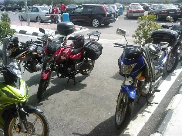

some pics r with micheal (sori if i spell ur name wrongly)
