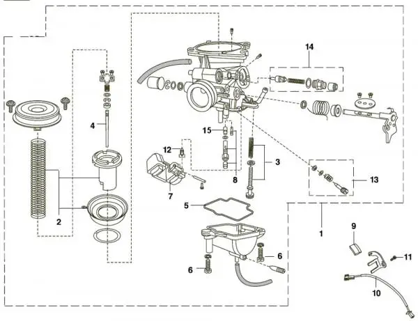

I juz replace my new spark plugs. Tested them werking by pluging one Spark plug at a tim and both at the same time. However when testing the right hand plug only, the throttling got stuck2 abit like pom......pom.......idling was ok thou. left hand and both plug testing was ok thou
Question:
izit normal for the right side to be like that? plug are new. or izit bcoz the combustion isnt comple that is why the pom...pom came out....
Left spark plug is a primary plug while Right spark plug is a secondary plug!
Primary plug fires at 350rpm and cut off at 9000rpm
Secondary plug fires at 750rpm and cut off at 6000rpm
The engine rpm limiter has been set up in the CDI
while the Ignition timing to have throttle response optimised is controlled by (TRICS III) the magnet assembly ( pic no 9) on the carburattor body and the Reed Switch Assembly from the CDI (pic no 10 )
(source manual book)

still doesnt explain y my splug goes pom.....pom...while throttling.... i dun think i throttle till 6k rpm. ...nvm i check again later....
Question:
sound from plug or engine?
hmm tot the manual stated very clearly ... since you are using the secondary plug only to ignite, the fire is not to it's optimal timing which all the input is controlled by the microprocessor in the cdi.
in indonesia, most prides riders that mod the engine installed 2 cdi's for each plugs to have the ignition timing for better performance.
for other option, some opt to play 'tricks' with the cdi by installing the cdi reactor or piggy back. This piggy back will fool the the cdi and will 'bypass' the Reed Assembly so to supply optimal input on the ignition timing ...
hahaha .. just my thoughts and i may be wrong kekekeke
