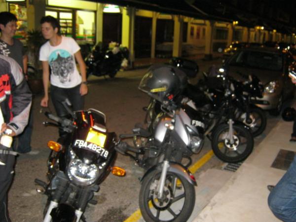

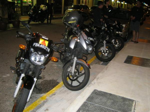

4 Pulsarians ... myself, solar, O'Ren and speedaddict. The other 6 Pulsarians went in JB. You were there or just passing by? :)
Yupp! Saw it there.. haha was eating there uh. If i'm not wrong, there were 2 silver, 1 blue, and 1 red right? Ahaha.
