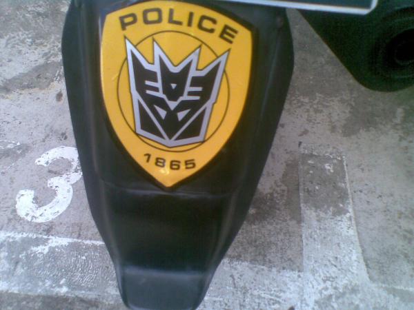

decepticons, arise!

arcee die way too fast :p:P
dun care la. i wanna my bike to be a female that i can RIDE on~~~ :angel:
woohoo! HAHA! :shy:
get it get it? :thumb:
