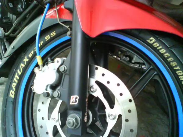

I believed you have read the pros and cons by now ... so this is what I can share to you ...
Stock tyres: The Option
Ask your self how capable you are to control this bike especially on braking and controlling. Different rider different style.
Practice braking on dry road and observe the distance effectiveness.
Follow the guidelines on safe distance and speed at all times ... slow when slow, fast when fast.
Change the stock rubber hose to steel braided hose.
Change the stock brake pad to a better brake pad.
Top up or change brake oil ... long used oil in the master cylinder will get blocked.
Adjust your rear brake effectiveness and clean as often as you can. At times you need to sand the brake shoes too for it's effectiveness.
Change new brake shoes when time to change.
Check your tyre pressure and pump in according the guides given.
Check your tyre thread tear and wear and the condition, clean or remove the surface from any objects stuck in between the threads.
Change tyres when needs too and don't wait till the tyre botak to change.
hope this guidelines helps just my 1 cent worth hehe... :goodluck:
Think of your LOVE ones at home ... it's YOU and your BIKE .. BE A SAFE RIDER :cheers:

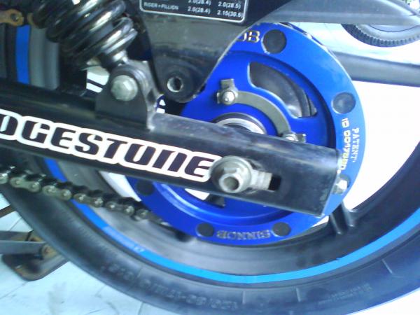

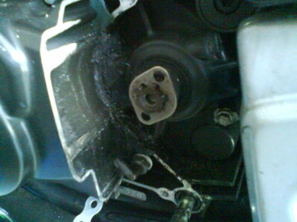

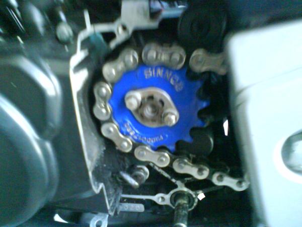

Part 2: InstallationDay at UM
Refresh ... remember Gaban posted on Sinnob .. scary right? Same with me lah... so that's why I personally directed all my doubts and ask lots of questions to Sinnob to have my doubts cleared.
Sinnob assured me that the new 2010 model have been revised and it's just Plug&Play or PnP (hehe not porting and polished ha)
To convince me to try the Sinnob, reasons they gave me the special FOC shipping cost.
Ok ... now the day of installation. (I'll be transparent as I can to share here)
At UM: After seeking permission to Jason and agreed ... and installation begins

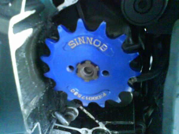

1: Installing the Rear gear was no issues PnP (pic on last post)
2: Installing the Front gear no issues PnP (see pic)

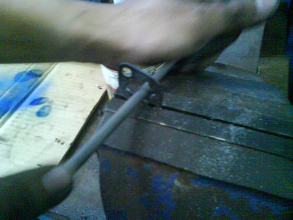

3. Retainer screw holes not align to front gear holes. Retainer teeth also a bit long to rotate to align. (Problem 1 - see pic)
4. Option to file or grind abt 1.5mm on the retainer teeth.
(sad to say at UM no flat file so have to use round file to file the retainer teeth down abt 1.5mm and took them 5 - 10 mins to finish filing) (see pic)
5: Retainer fitted and screwed firmedly on the front gear (see pic)

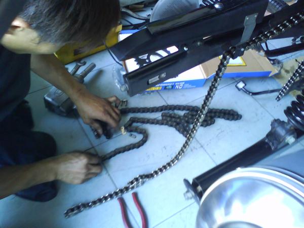

6: Chain DID 520 silver plated intalled and find a bit too long for my bike. Need to cut 1 psc away. (see pic)
7. Sinnob nicely well fit after the second obsticle done. (see pic)
8. Tested the rotation .. seems fine but end to its stop, a knockins sound heard .. carefully checked on the rotation of the front gear, rear gear and chain and found the problem. Sound came from the joint clip of the chain when it arrive at the rear flanges. (see pic for ref only as I forget to take the foto on the joint clip .. nx time ok)
9. Lucky the flanges are made of polyurethane (rubber thingy) so it can be expanded and will not surface any problems ahead.
10. After a while of test ride, now the sound totally dissapeared.
hmmm .. since the attached pic can post max 6 only .. here I proudly to represents my Sinnob on my SplitFire and the verdict on the next post .... :slapforehead: hehehe

The results of the Sinnob on my SplitFire, I will post soon after finalising the difference from stock no doubt the significance really shows right after Sinnob was installed as most UM mechs there want to see the difference. :cheeky:
Will update soon ... don't know why too HVC keeps silence till now :cry::cry::cry:
Btw .. my Sinnob chain needs to cut 1 pc away but for HVC is PnP .... why? ... hmmm coz same model does not mean same specs and performance!! simply just like a twins ... hehehe :cheeky:

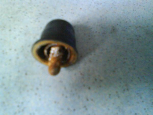

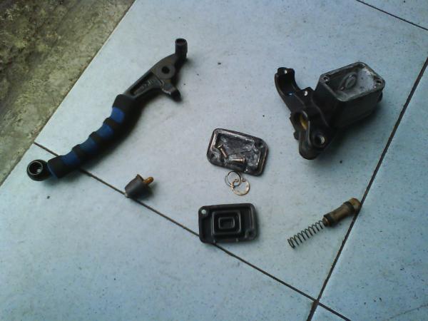

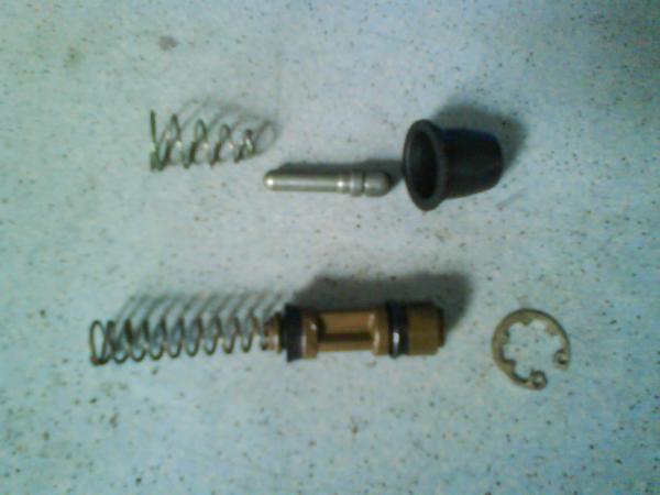

Today went to UM again to have my front brake lever check ....
Mech Ah Teck check my bike and dismantle the master cylinder and found out that the kit pump spring has rusted and the rubber has wear too.
It's the reason behind why my rear brake is ON even though I did not press or step on the brake lever, thus making my alarm alert activated occasionally after I switch off the engine.
Change the whole set of the kit pump, clean and top up the brake oil .. adjust the tension plus checking what ever needed .. all back to GOOD...SATISFIED! :thumb:
However damaged was $46 .... but it does not harm that much ... SAFETY most IMPORTANT!!!! :angel:
Kudos to mech Ah Teck again... a reliable mech.:thumb:

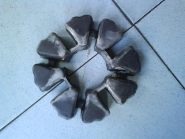

Before.. one of the reasons why my SplitFire has some wobbling at slow speed...
a wear and tear of the rear of the rubber coupling in the rear brake drum...
damaged for this item .. $10.50
How to notice? .. try giving a shake or push and pull on your rear sprocket andtake note whether it loose or not ... loose means 2 things .. either the rear wheel bearing or the rubber compound or both ... both damage price is $10.50 each.
Do give a check hehehehheh

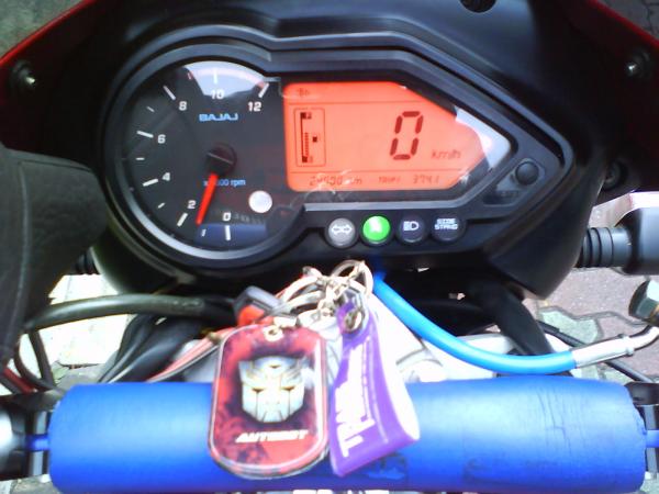

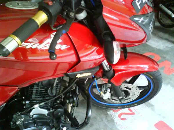

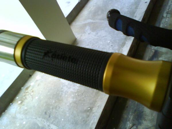

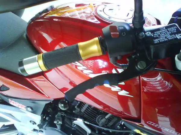

oh .. btw ... do check picture 4 ... see my new throttle grip? .. hahahah
mj
u really change alot of things
haha
nice colour for your throttle grip:thumb:

hahaha ... so price how much? can remember?
What I know for P200 full set Sprocs and chain at UM is $136 with labour.
so ex?
i changed my sproc and chain during my 2nd servicing
normal chain with 15 Front and 39 Rear Sproc
the whole sproc chain set $75
labour free
Ride Safe
Arrive ALIVE
so ex?
labour free
520 or 428 chain size ... o_O:confused::confused::confused:
PULSARIANS SINGAPORE
what i meant is that i have already changed my
currently my is on 15 Front 39 Rear
so ex?
labour free
i went back to see the price list and saw pricing of the sprocs
think maybe p180s and p200s sprocs are different
cos the price so much difference
i rmb asking jason when i wanted to change my sprocs what is the size the p200s are using and ask to change to that
not sure on this might be cos the holes/bolts/screws different sizes and length
Ride Safe
Arrive ALIVE
haha
that i dunnoe
cos i nv ask
is there a difference in the chain size
cos when i change i did not ask them about the chain sizes
just told them to change the whole set

hahah went to Moto World for chit chat with my relative who's working there after my school at Ponggol the other day..
talking about Rizoma stuffs and he said if I'm interested to have one like Rizoma with a lower budget ... so curious I said ok which one and he pointed to this model ... Ariete Products.
First look only .. I said Ok can fit Pulsar? and he said Universal stated there .. hahaha
2 colors available for this model .. Black and Gold ... hmm actually I'm looking for Blue hahaha :cheeky:
Verdict:
Ok .. Left side Throttle... just PnP .. (hehehe now seems words PnP always in my mind hohohoh.. poison from Prides)
Right side ..
1. hmm need to file or grind to flat the lining on the surface and you really need the air blow gun to slide through
2. need extra washers preferable spring washers 4 - 5 pcs to have the end weight fully grip and tight. But not sure if one use stock end weight though.
Overall ....
Looks like Rizoma even UM mech thought it was Rizoma heheh :thumb:
Feel the rubber grip .. soft and comfortable :thumb:
Price ... if you opt for Harris Grip which is around $36 a pair ..
this Ariete Grips actual price $65
offered at Moto World $50 only.
And if you want to DIY is $55 heheh .. ... :faint:
looking at the trouble to fix on the right side better let them do lah .. some more cheaper than DIY .. funny though
Actually looking for helmet but ended buying the throttle grips instead hehehe :cheeky:
oh btw .. while waiting for the Tarnsformers Autobot logo from Aurthur .. bought this for at Vivo Toys R Us hehehe . actually for handphone lah hahaha
Tranformers never die .... :angel:
