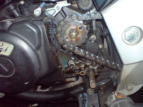

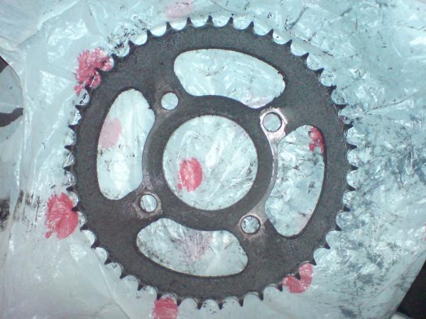

Hi Guys,
Just came back from LAB. I have changed my both sprockets and chain. The stock ratio was 15/43 and the new ratio is 15/38. Chain is DID 428 roller chain. I believe it is standard non o-ring chain. Installation was quite straightforward and no mod was required. Total cost including installation 35$.
I havent got a chance to test the top speed and rpm at that speed as CTE had quite heavy traffic. But I could clearly notice that now gear shifting has to be delayed, I couldnt shift to 5th gear below 60 kmph, I was pillioning my wife BTW. The gear shift is now slightly harder. Also,Earlier when I would accelerate, both the RPM needle and speedo needle would move up in parallel but now the RPM needle lags behind, kinda looks odd :)
Here are some pics of the front and rear stock sprockets.
Hi Guys,
[ATTACH=CONFIG]183817[/ATTACH]
[ATTACH=CONFIG]183818[/ATTACH]

No need to change wheel hub, bro. The rear sprocket is perfect fit and identical to the stock, except for the reduced diameter. I believe if you need to convert the 6 hole sprocket to 4 hole then you need to change the wheel hub or if the sprockets holes position is different. The owner of LAB is really an expert.The moment I said Bajaj sprocket he said he has, then he asked me P180 or P200, I said P180 and he replied "cannot". I told him it is 4 hole same as P200 and then he said ok :). I called up Unique motors and that guy said he doesn't have stock and needs to order, even though they have 4 hole sprocket, it seems all 4 hole sprocket are not compatible. Anyways LAB rocks:thumb:
I have heard comments that their workmapship is not good. But I dont think that is true, because I saw them doing some complex stuff on bikes like Super4's and Phantoms.

from 43 to 38 is a slightly big jump. u'l lose pickup power but not as bad as mine. im using 15/37 which i cruise 100km/h at rpm 6.9.
depends on individuals perspective. almost every workshop can service Honda. try doing it on a Hyosung.
Yeah, its true, pick up is not that gr8, I had to like clutch in quite often while riding in little india jam, but I travel from AMK to Changi business park daily, about 44 kms over the TPE, that journey will be very pleasant now :). Another thing is I had changed my tyre to Dunlop TT9900 which is 100/80 smaller than the stock 100/90, I read that if rear tyre circumference reduces then gearing becomes short so that slightly compensates the tall gearing due to sprocket change. I have read so much about sprockets and gear ratios in the last few days it feels great to actually apply what you have learnt :)

Thanks MJ bro.
This site is awesome. According to it with my stock gears(15/43) and rear tyre(100/90 R17) @ 8000 RPM my speed was 100.4 kms/ hr.
Then I changed to Dunlop TT900(100/80R17) which reduced the speed to 97.1 Kms/hr @ 8000 rpm.
Then I changed the rear sprocket to 38 that increased the speed to 109.9 kms/hr @ 8000 rpm. Perfect:thumb:
