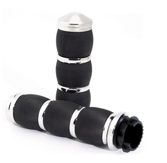

Back to the gear acquisition + mod topic, I'm actually looking to find replica/original kuryakyn iso grips OR Avon grips in SG. Anyone can point me in the right direction? XD
http://www.motorcycle-superstore.com/ProductImages/300/0000_Kuryakyn_Universal_ISO-Grips.jpg
http://img.photobucket.com/albums/v671/jim3553/Post%20Pics/Avongrips.jpg
I currently have these but they slip alot when I'm wearing gloves. Hope the avon/kury will provide more grip. :(
http://www.m109bikers.co.za/images/custom/ribbed.jpg

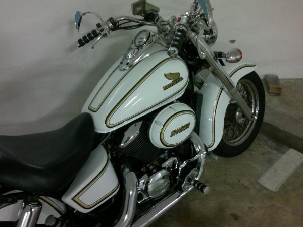

My Shadow400 wif retro honda design[ATTACH=CONFIG]267484[/ATTACH]
Welcome and more pics pls
Nice shadow
