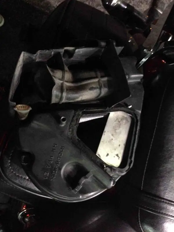

Anyw something interesting I found out today. Okay back story, roughly over a week ago I changed out my air filter and Rosli cause the air filter.. was impossibly choked. Got a new one from Rosli who advised me not to go after market for now at least. That very day my coolant leaked so I brought the bike back to Looi's (okay thats the first time i'm naming the dealer haha) and they changed out the bottom coolant hose for me where it was leaking. 3-4 days later, the top hose started to leak so I brought it back and saw them strip the top parts of the bikes (fuel tank, filter housing etc.). I left the bike there, came back and they informed me they changed out the top hose. I also told them about the jerking issue and they said they would look into it. That was saturday when I got the bike back. Today I went down to JB, and my whole filter housing dropped out. Strange? I brought it down to a nearby mechanic to fix it back cause I didn't have the tools. And thats when I discovered this..
[ATTACH=CONFIG]306616[/ATTACH]
There's a metal piece screwed into the housing which wasn't there before I know because I opened it up myself before I went down to rosli. Its restricting the air flow by nearly half.. and the screws are so badly put in they poked through the other side, which prevented the housing from being properly secured. All these was shown to me on the spot by the mechanic. To rectify it he took out the extra screws and the piece and secured my housing back properly.
I don't think Rosli would put something like that in without telling me, or even do something like that at all. I intend to check with him.. but I highly suspect its the mechanics at Looi's. My question now would be, WHY WOULD ANYONE DO THAT?! Tried googling restricted air intake and the closest that came up was ram-air intake which is totally not what this is about. I'm in a state of confusion now hahahah.

What are the things that Rosli fixed for you? If only air filter, I doubt he will open up the whole air box.
Go back to looi and tell them to fix it back properly. Tell them u are very frustrated to keep coming back every few days, and strictly request them to do a proper checking of the bike one and for all.

I believe reducing your air intake will make the bike incapable of reaching such speeds rather than having "the struggle".
Dragstar 400 classic & Zx6r
restricted air intake so that you bike won't jerk, but lose of power.
my was stick with sponge. after the took out yes it jerk but with power.
was done turning by rosli getting better but not 100%
perhaps changing your fuel pump>?

Update! Went down to rosli today and he said the same thing that many of the bros here have suggested, that restricting the air intake would smoothen out the jerks and cover up a major problem. Brought the bike back to Looi's and gave them a piece of mind regarding their shoddy under table fix. The good news is that they didn't deny anything and admitted that they took a short cut to "save cost" for me, the client. Well in any case, since they bothered to admit, I threw my bike to them to give me a full detailed diagnosis of what is wrong. Last chance before I bring this matter up to their boss and subsequently CASE.

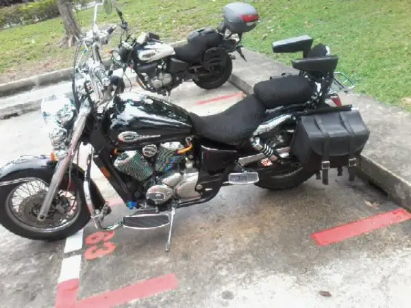

Sharing a picture of my 1998 Honda shadow ACE
Occasionally adding accessories here and there.
Front Chrome trim
Front Chrome accent
Carburetor Cover
Front Mudguard(So Important! Flying debris destroys the lower fins of the radiator!)
New Aftermarket Radiator. ( With Prestone 5 year once coolant)
Radiator Reflectors alike US models.
Engine bars a.k.a crashbars
Highway pegs.
Ultra wide Riders floor boards
Spotlight with visors
10" Mini Apes
Chrome Round mirrors
Wide chrome levers with skeleton face at end
Used a steed speedometer and removed the tank assembly
Progressive front Fork springs from progressive suspension
11.5 Inch Heavy duty Progressive rear suspension.
Uni High performance air filter(Re usable)
No cushion for rider. Tapered sponge for pillion.
38 tooth rear Sprocket
Passenger backrest, sissy bar and luggage rack
Passenger floor boards.
Some random saddle bags.
Custom running chain oiler.
Painted Engine case and spokes.
Dont mind the passenger armrest.. experimenting the viability.
She was giving me 23 KPL before the change to iridium plugs and mobil 1 10w40. Now 21 ):
