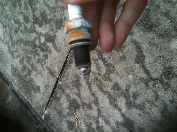

In my case, it's super lean! Checked my spark plug tip and saw that it's white, very very clean, like new, even though the outside screw thread part is is abit rusty from the rain. Clutch freeplay also not enough.
