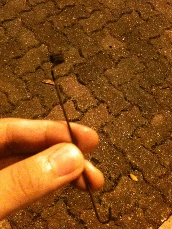

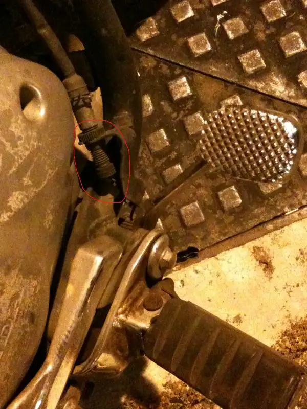

Hi guys, this metal coil found near the rear brake pedal rusted and broke off. Does anyone knows of its function, the impact of such damage, and the possible fix to this problem? Thanks a lot in advance. I have attached photos of the problem.
dats your rear brake sensor. means now since its broken, wen u step on d rear brake, the brake light doesnt come on. better get it fixed since its a safety issue wen other motorist can't see you braking.

ok i went to get this fixed, so its just a few dollars to get it done. Just to share a possible solution to the popping sound at the exhaust when throttle is closed, a possible fix is to change air filter.
