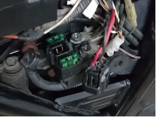

Tried to jump start the bike from the car battery last night. And still it don't start.
Again, it make a single click sound & nothing happen.
Check the 10A ignition fuse and it is OK. Notice another assembly below the fuse box; open it and saw 2 nos of 30A fuse inside (this is probably the master fuse box). Remove them (1 was tight in the fuse holder but the other slide out freely).
Visually check both and they are OK too.
It was almost 10.30pm and decided call it a night. After putting everything together, decided to give it a crank.

Check with a multimeter last night. Both 30A fuse are OK.
Also discovered that only the 30A fuse on the outside is in use.
The other fuse (inside) is a spare because there is no metal part in the fuse slot.
Bike still start fine last night except for the original problem from last Friday (starts but die off when idling).
