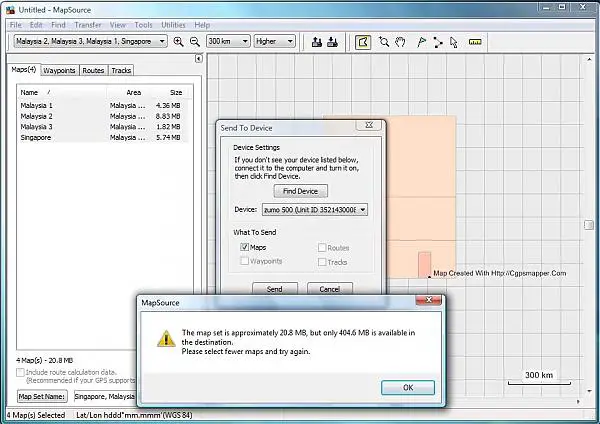

Need help, i had Singapore/Malaysia City Navigator NT v2.72, tried to use MapSource to upload the maps to my Zumo500, but it pop out a funny error, please refer to picture. However, no problem with MSM or MFM. Anyone know how to solve it?

The pic abit small.
It seems like you do not have enough memory in your Zumo to upload the selected map tiles.
Why don't free up some space by deleting the pre-loaded map (usually the biggest single IMG file) after backing it up in your PC.
Anyway I have never tried uploading maps directly from Mapsource into Zumo, is that possible ?:?

The pic abit small.
Sorry for the small pic, the error message actually quote:
"The map set is approximately 20.8MB, but only 404.6MB is available in the destination. Please select fewer maps and try again."
The strange thing is:
1. Destination had way bigger space than the map require, and its still prompting of not enough space.....
2. The map is a official Garmin Singapore/Malaysia City Nagivator loaded into a official Garmin MapSource software
3. MSM and MFM had no problem with MapSource whereas Garmin City Nagivator had error....
Anyway, let me check with Garmin tech support, thanks guys!
p/s: Thanks Rajeh bro for your recommendation of Zumo 500 at Perfect Watch, device works great and the shop assistant was helpful as well!
