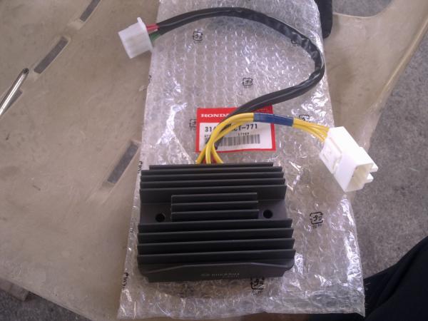

Hi guys, my rectifier is gone. Anyone change before can advise the market price?
Also, must we remove the whole front faring or remove the right side pocket can change liao?
What are the symtoms of rectifier spoilt?
bike is with me now. just charged batt to use for time being.
magnetic coil is working (all 3 main elect output wire have current), btw magnetic coil was burnt few weeks ago and changed.
Just tested at bike shop using multimeter. voltage at battery contact point only 12+v at 3-4k rpm. By right if charging properly should be 13+v.
Weak or non charging of battery. Meter restarts when starting bike.
Can be narrowed down to magentic coil or rectifier problem.
Then check whether is the electric output cable all three is working.
If no, magentic coil got problem. If yes then likely rectifier.

When changing the rectifier, must remove the whole front faring. Although the rectifier can be seen located behind the pocket on right, the wiring of the rectifier (black) goes across the headlight area to the other side of the faring. Secondly, the 2 screws securing the rectifier are quite inaccessible if accessing through the pocket hole only. Hence, to do a proper job, the entire front faring should be removed.
My charging problem was finally solved. Changed the rectifier and the magnetic coil (again) today.
Apparently, the rectifier caused my magnetic coil to be burnt in the 1st instance about 1 week ago. Did not change the rectifier then as it was still charging after I changed the coil.
However, the charging broke down yesterday again. Coil found burnt again. The rectifier was the cause. This time around, I changed both rectifier and coil. Kudos to my mech, he waived off the all charges for the magnetic coil and only charge me for the rectifier.
Lesson learned: Charging voltage needs to be monitored very carefully. A drop in the charging voltage despite coil and rectifier still working may be a sign where the rectifier is failing but not total failure yet. Hence if you ignore the signs, it will likely lead to a burnt coil. If your coil is burnt, it might be prudent to change the rectifier together (unless your rectifier is 100% working), else it might lead to another burnt coil.
