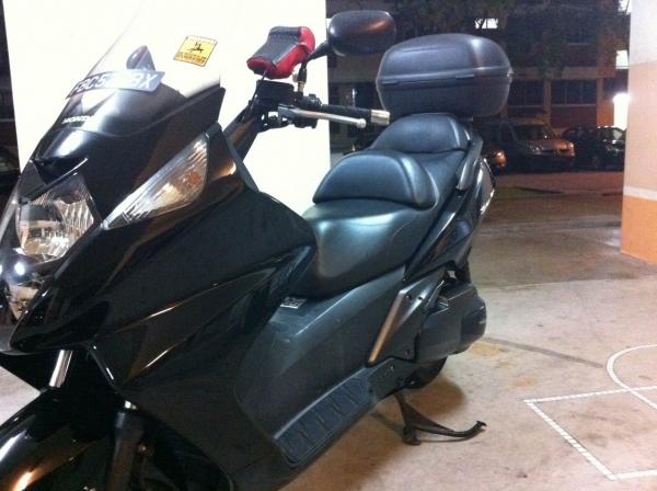

Brothers,
Just got my SW400 from direct owner a few weeks back. Totally in love with the bike. Just that it is rather heavy and quite long in length when compare to my previous SYM excel. So now I'm trying to find out more about this heavy beast and how to service it.
Mileage now: 22800km
Both tyres changed at 20800km
Engine oil changed at 20800km
I had read the manual and browsed through this tread and the tech tread and yet I still have some questions I would like to ask:
1. At what interval do you change your engine oil? The manual said 12k and someone else said he changed at 2.5k.
2. When you service your bike, what else do you all normally change?
3. Which bike shop will you recommend? I'm over at west side. I saw the list provided by Scoobydoo in the tech corner and it is such a long list. Haha
4. What are the things I must look out for with this bike?
5. And any great advice you can give me.
Thanks in advance!
P.s. I would like to join those trips you guys have been planning in the future if I'm available.
