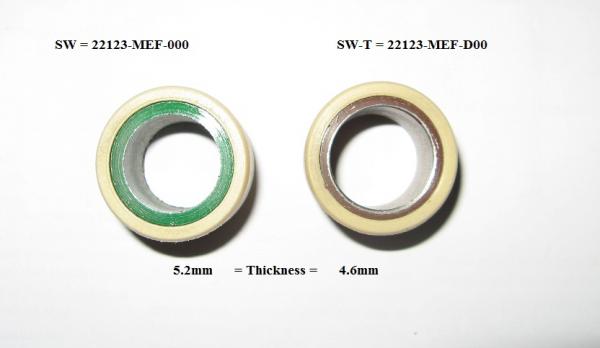

Bike was feeling so terrible for past 1 week.
Drop in power (no pickup, stressful to speed), engine/belt compartment loud and rough. *Vibration felt through the handle bar and seat.
Very jumpy over rough road surface. *This one not sure... possibly due to uneven wear on tires (10k liao).
Just did a belt + roller change at ACM. Including spark plugs, air filter, EO, EO filter and gear oil (Maxima 10W40).
Hmm. Everything back to normal#. Yeah!
Will go service my brakes tmr morning. Promised K & T already so must go back.
Confirmation on the rollers.
SW = green rollers.
SW-T = red rollers.
Comment on Performance difference:
Stock SW-T red rollers have better pickup and quicker response.
Green ones are more calm and gradual. So much like my previous SW.

3-in-1 was $200.
Labor charge for everything was $30.
Competitive pricing.
