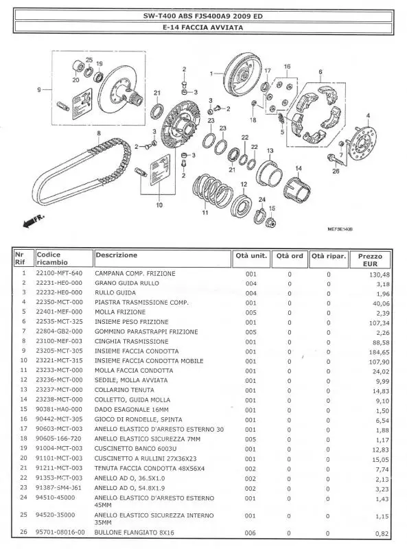

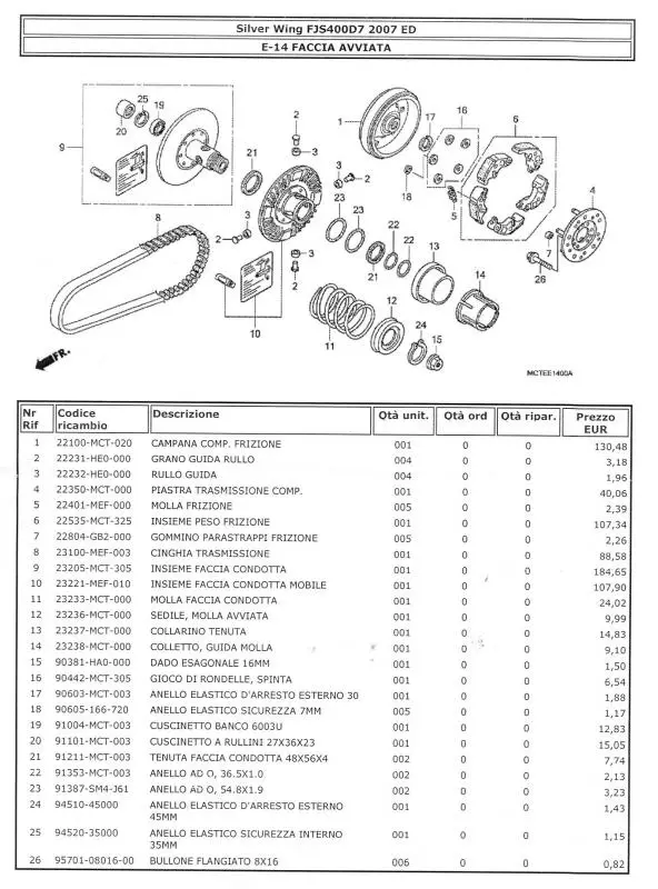

Just found that the clutch bell for SW400 and SW-T are also different part number. Why? Because SW-T comes thicker (1.5mm) thus no pigeon sound.
http://66.163.168.225/babelfish/translate_url_content?.intl=us&lp=it_en&trurl=http%3a%2f%2fwww.silverwing400.it%2findex.php%3foption%3dcom_content%26task%3dview%26id%3d280%26Itemid%3d83
SW400 *Look part number 1
SW-T400
Great! It's like CB400 using upgrades from newer spec3 / revo. So can FJS use SW-T clutch bell?
Checked the website can last for 80000km?
80kkm for cars; my car iridium lasted that long. Half it for bikes as higher rpm.
Should be ok since they both using same clutch pads.
[ATTACH=CONFIG]240893[/ATTACH]
SW-T400
[ATTACH=CONFIG]240894[/ATTACH]
Anyone replace ur clutch pads and bell b4? And visible different? As in the power and smoothness does it improve?
:cheer:
Glad to have u in my life : ) Always love one another!
Everything should be the same except the reduction of pigeon noise due to thicker bell wall.
