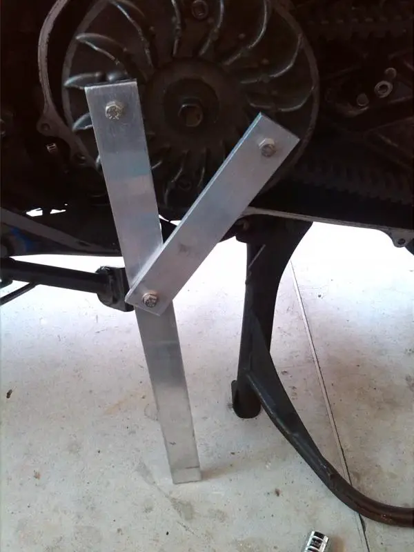

some advice if u are using the electric 12v "gun" to remove the variator
(1) are you able to loosen and tighten the variator nut without using the Y-tool?

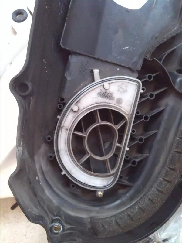

(2) is there suppose to be a foam or papper filter at the white cover?

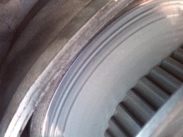

(3) the groove at the variator survace are obvoius to touch already, is it time to change? Any estimate $$?
I cant remove the variator nut because it has been previously tighten by workshop air torque gun.
Used my DIy Y-tool to pry it until i lifted the bike :lol:IMG_20140209_134755.jpgIMG_20140209_134902.jpgIMG_20140209_135622.jpg
Honda ..................and nothing else
Yes
Yes, a foam filter. Can DIY.
If it's at the edge, sound be ok. Can use a fine sandpaper to smoothen it. Couple of hundreds to change. Scoobydoo knows.
Variator:
Outside plate approx $45.
Inside Plate (roller holder) approx $75.

Edit : Uncle...where do you buy the appropriate foam filter to DIY?
If big piece I buy liao cut and distribute
One of those high density foam. SW9000 also DIY as no ready stock in SG. Give you my spare piece if you want as no longer need.

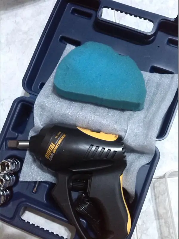

Home sweet home with the foam from Uncle and the 12v ratchet
Anyone DIY having problem remove the bloody variator Nut feel free to beep me :deal:IMG_20140210_175610.jpg
Am I suppose to oil the foam before putting it? totally no clue since mine dont come with one
Anyone DIY having problem remove the bloody variator Nut feel free to beep me :deal:[ATTACH=CONFIG]299098[/ATTACH]
The impact wrench will spin freely and engage the clutch only when it reach a certain rpm. Apply some air filter oil but don't over do it.

Usually I don't oil the filter as it only needed to stop big particles from messing with your belt and variators.
Must wash periodically to allow enough air flow to cool the transmission.
I use Red Sponge, cut to size. 1 piece can make 3, I think.
