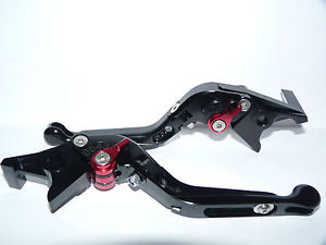

Hi gurus, any 1 know where can i get adjustable levers for silverwing?
[ATTACH=CONFIG]325393[/ATTACH]
we've not seen any aftermarket adjustable levers specifically for SW, but there are some that may fit SW.
you may wanna PM our kakis MaIkEr for more info, he got a set that could fit his SWT.
please DO NOT mod the stock levers by heating and bending them to desired angles.
imprecise and/or uncontrolled "heat treatment" of any metal/alloy (including SW's brake levers) will change their manufactured properties, including but not limited to strength and brittleness.
once the material properties, we don't know if those modded levers will be able to take the stress/pressure when you need to squeeze them hard (e.g. during e-braking) :pity:
