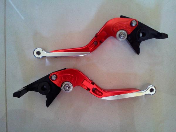

Have @ $120, adjust, fold and extend. sample attached.
PM me.
