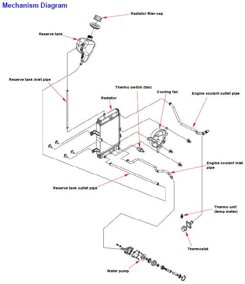

Here is the cooling system diagram for your reference. Did the mechanic bleed the cooling system during the coolant change, air trap in the coolant system can cause hot spot, there is a procedure in the service manual, also, was the thermostat tested, if is partialy stuck closed, it can overheat the cooling system.

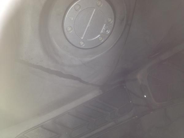

Thanks for all the advice...I am sorry for late reply.... really quite trouble by this problem.. I change the coolant
tank ( a white container with hose connect to it))for $100 dollar twice. Because my mechanic workshop is small
scale. my mechanic need to order. I wait for a week plus for the coolant tank to come.And I attach the photo of the coolant leaking out..(sorry not clear). Really appreciate all for the advice. at least now i had a clear picture what to look out for.IMG_0033.jpg
I guess only left 3 options....
