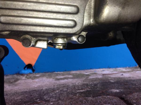

Retrieve my bike on tues 16/7
1)engine oil leakage settled . Due to screw not tighten enough

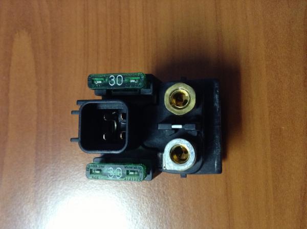

2) was told the fuse on the right side was loose, for the power issue
3) was monitoring the power issue till today, thursday 18/7,
Parked my bike for less then 15mins in the carpark as i was buying something from a shop nearby, turn on the ignition with no response from the bike again!!!!!! -_-" gonna call guan hoe tmr and gonna see how they can help to diagnose the error and kill it once and for all.

Recommend you check the batt connector screw. If came loose can cause intermittent on-off problem.

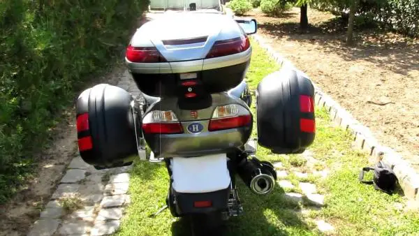

2) Been thinking for a while to install a hepco n becker alu box but also wan side box hmmmm any guys can share pictures? Only manage to find it on a 650
