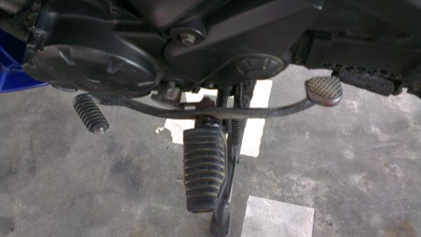

Guys i skidded during heavy rain and the bike dropped on the left side. Now i can't change gears. Its like stuck. Both up and down gear cannot. Its in 1st gear now. Does anywan knows how much will it cost to repair it? What will they do? I have uploaded the picture. Thanks!

Price range between $50-$150.
Yup should be around that range since from what we see here its the gear lever that's damaged. Best is if you can call a garage and ask them to check everything properly.

There is a screw securing the gear shifter to the engine. Unscrew it & try to take out the gear shifter. If you have a hammer, knock the gear shifter back to straight and fix it back. Ride to a bikeshop or LAB and ask for a new gear shifter. New ones cost around $18 to $25. Fix it yourself & you are good to go.

Alrite thanks bro.
Bro i duno how to explain.... Its not the black gear shifting thingy. That one i know can use hammer to make it straight back. But i cannot up or down gear.. The gear like stuck... I am stuck at 1st gear. Cannot change gears....So i switch off my bike with 1st gear...

Even if you straighten the shifter you still cant change gears? Probably the shaft is damaged or misaligned. Tow it to your bike shop and get it checked. Easier, rather than we all just tikam tikam the price.

Some people say I never help others but I shall make it an exception this time. Clue for you. Your bike is stationary so cannot change gear. Figure it out and you will be able to. :cool:

Ya. I cannot change gears. Its stuck. Ouh shaft? But Its stuck at 1st gear bro. I can start the bike. I will slowly ride on 1st gear all the way to the workshop.

Ouh...Well the gears are stuck. Its in 1st gear though. I will ride to workshop and do it...

it wont cost that much.. let me have a look

Precisely. Suspect its just the gear shifter & no internal damage.

I repaired the gear ready. The mech just hammer the shifter gear back to straight and tighten one of the screw or something. I can change gears ready just that gear 4 no light lights up! Anyway thanks alot bros!! I also change the engine oil, Coolant and spark plug. All together was $70
Xrev engine oil = $15
Agip Coolant = $18
NGK spark plug = $7

Told you already it wont cost much as its just the gear shifter. :thumb:
