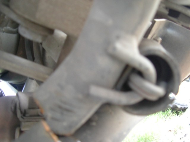

Originally posted by vtec666@May 13, 2007 02:33 am
BA
I ask from HKL and bukit Merah ......
See the parts of the /-\ Centre part , it breaks on the curve part .....
Hi Vtec666,
Yours can be weld as the corrosion is not as bad as seen on the picture. After welding add a reinforcement rod between the legs.
Can save money instead of getting a new center-stand.
Remember it's better to remove the stand to weld so a proper weld can be done.
Silverghost...o_O
DIvErTeD SpiRit...
ThE SpIrIt StIlL LiVeS On "Diversion XJ9s"
safe riding yOu BuGgErs
... SiLvErGhOsT...
Originally posted by SiLvErGhOsT@May 14, 2007 09:09 pm
Hi Vtec666,

THANKS, will remove it ......
Hopes a better re-inforcement for the welding of the bar .
