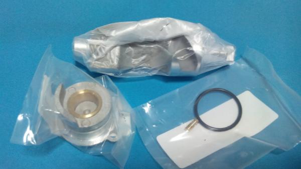

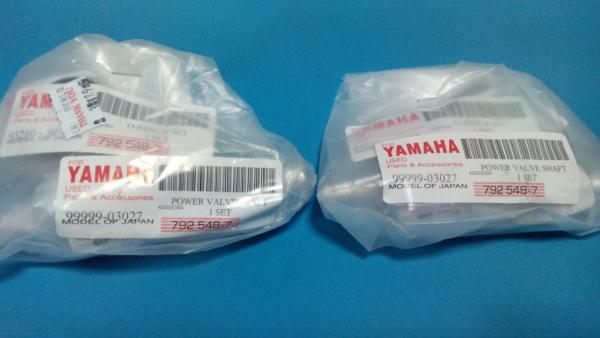

Power Valve Complete Set For Sale!
Includes:-
1) Power Valve Shaft
2) Power Valve Cover
3) O-Ring
For Sale $20 each set. Left 2 Sets Only!
Self-Collect At Jurong West or Lavender St.
All SOLD!
Edited by raislyn77
SOLD!

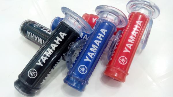

Yamaha Hand Grips For Sale $12/pair.
Limited Stocks!
Self Collect At Jurong West or Lavender St.
To Deal Txt Me At 90060693.
Limited Stocks!
[ATTACH=CONFIG]292696[/ATTACH]
Now $10 Only!
