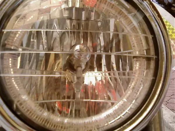

HEY!! i need help!! my bike's angel eye is not bright enuff.. as in... can hardly see the eye~ the attachment at the bottom is show when its not lighted up. gonna improve on it~ Or izzzit i put the side where we saw the line inwards. dats why its not bright? mine is a 10mm rod wif a 5 mm led~
ur rod too thick liao.. 8mm more den enuff liaos =) the line u cut is face inside the opposite side facing outside..? u show a lighted one? from ur pic i see quite ok mahs.. u on ur angel eye show me u on when in de dark la..
did u test ur AE before putting it in ur headlight ?
wads ur resistor value ?
hmm .. btw i used 10mm rods for my AE's
dun think thickness is tat of an issue :)
i noe thickness not issue.. but too thick the light oso cant shine out nicely but 10mm so far is ok.. dun be like the fierymonkey uses the super thin like 6mm lidat make the whole angel eye like *toot*~

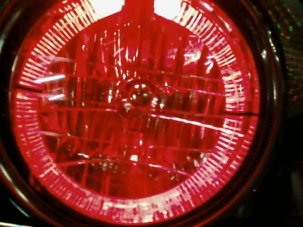

yeah bro. my lines are facing inside! ok. i've uploaded!!! plz check it out ok? must tell me where is the mistake!!!

yar .. saw the line deeper and thicker
than put some reflective tape or foil around ur led and the back of the AE
coz ur light seems not concentrated
ur problem from what i see is that u didnt mask the part where the led is being slot in, therefore the light spread out.. try masking it with heat shrink tubes or u can wrap aluminium foil around the part where u insert the led, then wrap it wif black tape.. gd luck

OK! thx! i'll try to touch it up~
