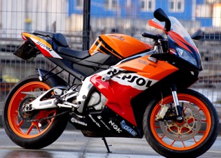

Hi Bros! Currently my RS125 is under run in. The max I could whack is 72km/h wit 4700 to 5000rpm. Is tis normal? My frenz told me after I reach certain milage will increase. Is it true? Please enlighten me:)

very normal ...like you said .. still running in , so everything takes time ? like a baby cant run without starting to walk right ? wait till everything season .. hohoho , you will be a happy rider.. but SAFETY 1st.. :cheeky:

if u truly want to break in the engine properly.. twist the throttle n whack ur bike HARD.. dun restrict urself to wat rpm n speed.. all tat is nonsense
This is in simple terms race-style break in, based on the concept that the piston rings' need to be honed to the cylinder walls before they lose their flexibility (or something like that).
Thus, varying the load on the engine (go Neo Tiew!), running through all the gears will break-in the engine much more effectively than a manual-recommended, gradual break in. You will not do the engine any favours by cruising at 70kph on the highway. Go do some backroad time attacks.
Make sure you warm up the engine before you start exercising, it's just like going to the gym. You won't have good results if you straight away sit down on the bench press and do 200kg weights immediately (you'll start destroying muscle mass.. or in this case, your engine).
There will be a lot of wear and tear so change your EO often during break in. Some say "change after the first twenty miles" and then every 500km but suit your budget.
Do not run in using synthetic oil, use mineral EO and change it often.
After 2000km, the result is a bike that is significantly more powerful feeling than your friend with the gentle break in.
Remember no pain no gain, go whip your horse :p
Bibliography: Mototune USA break in secrets
Practical use: Phantom can ride like sportsbike? Can!

I rode 2 strokes before, just treat it like normal engine bah. I took the advice of bike shops to take it easy for the first thousand miles, but due to traffic I had to vary the speed, gear and throttle a lot, which did good.
I didn't change the EO as frequently as I do now but on hindsight it is a good idea. The reed valve system isn't designed to shed debris created by wearing in the piston rings and we are using shared sump so if want engine/gearbox to last, change the oil lor. After all the lower spec EOs are dirt cheap. No need to change 2T because it's an expendable commodity stored in a remote reservoir. It doesn't suffer degration from temperature, pressure, moisture and shearing like your EO.
My 125Z is unbelievably fast and uses little fuel because of not riding at 60kph for breaking in (it's totally stock). Had to overhaul a couple times during its long life and didn't really care about people asking me to go slow on the break in. Just started riding slow, got used to the feel of the engine, ride normally at first.... then abnormally... then...
Bt bro my milage is 650km already. Bt my RPM still at 5000 n I can't whack more then 73km/h. My frenz r telling smthing is wrong wit the bike. Can enlighten me...

Bro I brought my bike to mah motors as they r the agent for aprilia. They did the setting n everything. Nw is normal. Can really feel the power. I was told tat I shld go at 90km/h until 3000milage.

Anyway, when running in is running in. just be patient, and after run in, u wan to whack all you want also can, but control man. Anyway, piece of advice, change your 2t to Agip or motul as your 'agent' is supplying you with SPC 2t if im nt wrong. BUT PLEASE DO YOUR RESEARCH FIRST, as different people want different things for their bikes.

Just exercise progressively lor. Bike won't explode wan.

It's okay bike will wait for you - just continue the run in process, but change the oil out first. This will remove the bits and pieces of metal dumped into the sump during that 10 days of breaking in, and refresh the additives of the oil.
Oil does degrate on the shelf (5 years) but once poured into your engine it has to deal with acids from combustion and now, from sitting still, absorb condensation every morning. So it will degrade faster. My SOP is to change oil if I didn't ride for a very long time (more than a month).
