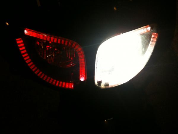

Angel Eye lights are suppose to be installed inside the headlamp. So it means, there is a need to dis-assemble the Plastic/Glass Lens from the shiny reflector.
There are a few vids on Youtube regards to Car Angel eye installation which might be helpful.
All the best.
1) remove headlight from bike
2) remove all bulbs & wiring from headlight
3) put headlight into oven (YES, a oven) to to soften the glue that holds the clear plastic & the casing.
4) separate the clear plastic & casing using whatever tools u're comfortable with. (2 x negative screw-drivers will do the job)
5) position the angel eye & stick it to the position u prefer. (might need to drill a small hole for wrings)
6) test to make sure it lights up. (This step is important, if not u will have to redo step 1 to 5)
7) glue the clear plastic & casing back together using silicon. (make sure no leaks, if not it will fog during / after rainy days)
8) put headlight back onto bike & connect wiring.
Yes, it may be simple to some & way way too difficult for others.
usually, it's step 3 & 7 that is hard.
