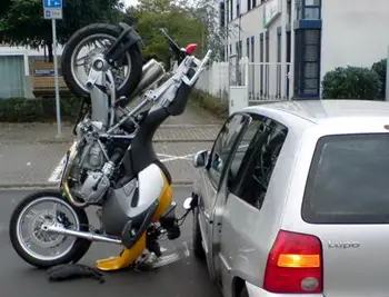

:cool:
[ATTACH]60124[/ATTACH]
Nice stoppie:thumb:
At least the rider only need to repair the front of the GS... :sian:
