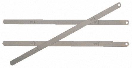

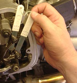

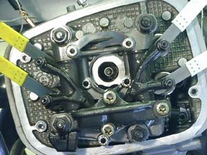

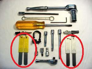

Does anybody know where I can buy feeler gauges? Those hardware shops that I went to only have the linked types (1st pic).
But I think I will need separate gauges to adjust the valves (2nd pic).
Enjoy, since you have done yours, can you give any advice?
currypuff: I went to more than 10 hardware shops around LAB area. Couldn't find any of them selling the gauge separately. I bought 2 sets in the end. Do make sure that u have the correct measurements (inches/metric).
:cool:
Thanks for the replies.
According to the instructions, you need to insert all 4 gauges (2x0.15mm, 2x0.3mm) into the valves together. How can you do this with a bunch of gauges of different sizes stuck together?
Jason, I checked the RS website. They do have individual size gauges. However, from the illust., they look very long and unwieldy. Any other choices?
You can also try Farnell... :)
