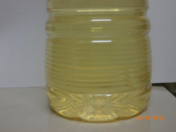

Caltex techron very good for engine
I just took sample into bottle transparent
notice it is so clean

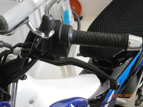

changed

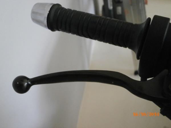

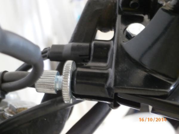

1. lever assy clutch one set . It includes switch assy and lever clutch.
57500-25G30-000 LEVER ASSY CLUTCH - one set RM42.80
comes with
57470-25G01-000 SWITCH ASSY CLUTCH
57620-23F00-000 LEVER,CLUTCH (BLACK)
RHS LEVER ASSY, BRAKE 57300B21D10N000 - one set RM17.80
above components used by NEW Raider 150 model yr 2014

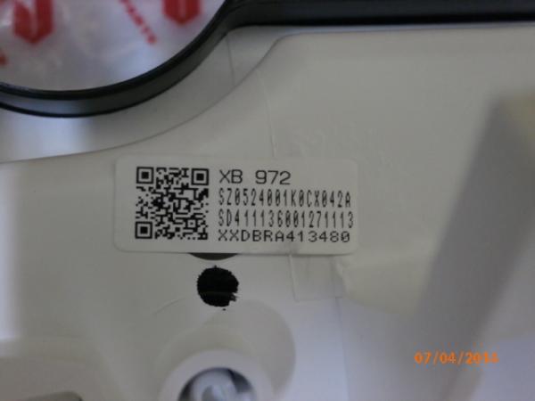

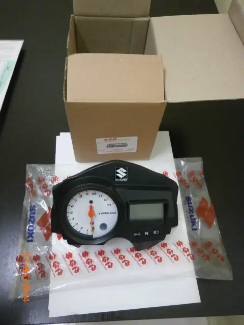

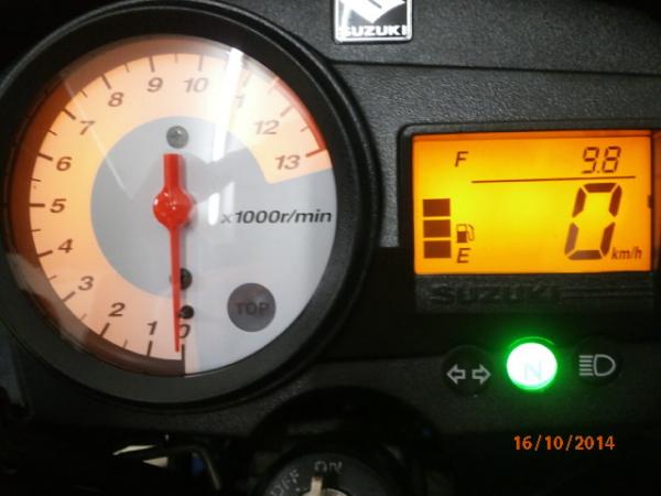

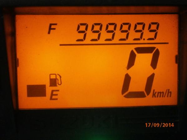

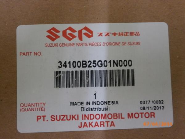

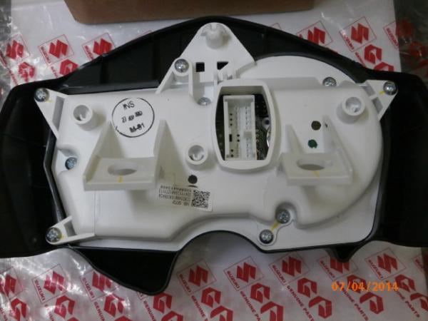

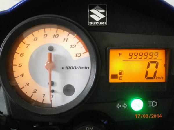

16 oct 14 change new speedometer
99999.9km hang
never spin
Suzuki did correction and new part number is
34100B25G01N000
01 means minor change
SGD65

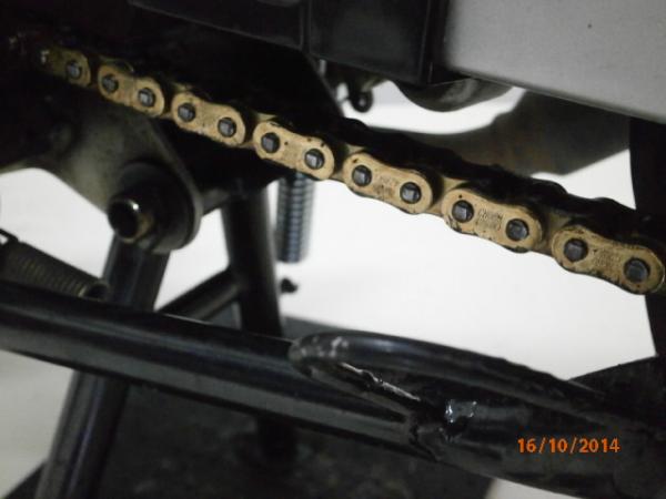

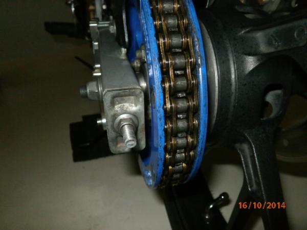

16 Oct 2014
99999km
JB
sticker no.1 stick fuel tank indicating bike completed 100,000km
Fix new speedometer. Suzuki did correction and new part number is 34100B25G01N000. 01 means minor change

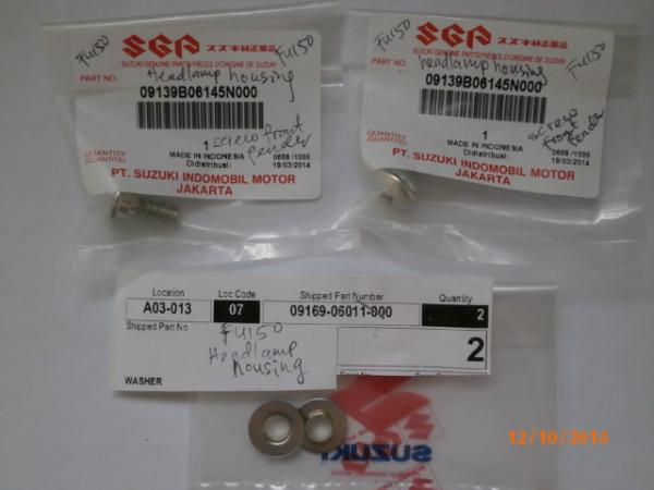

New 2 nuts for headlight cover.
New 2 washer for front fender.

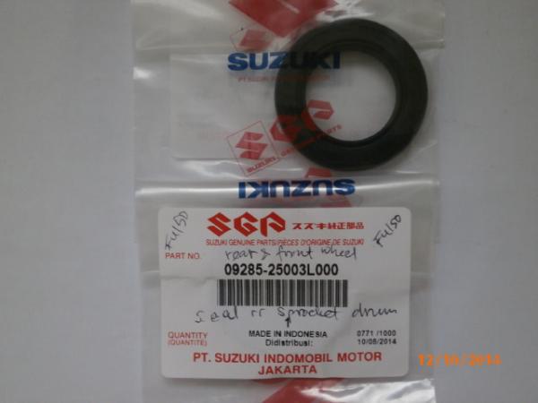

front wheel grease pennzoil and
changed front wheel 2 seals
changed fork oil ELF synthetic 5W

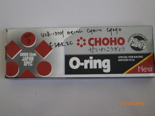

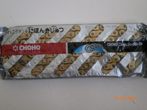

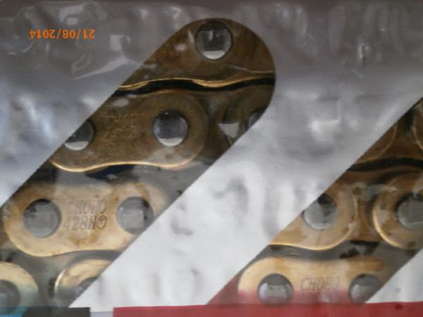

Sinnob + + chain 428 O-ring Choho Made in CHina RM75
1100ml Shell R4 + oil filter
fully charge battery
