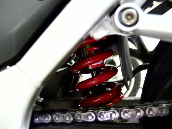

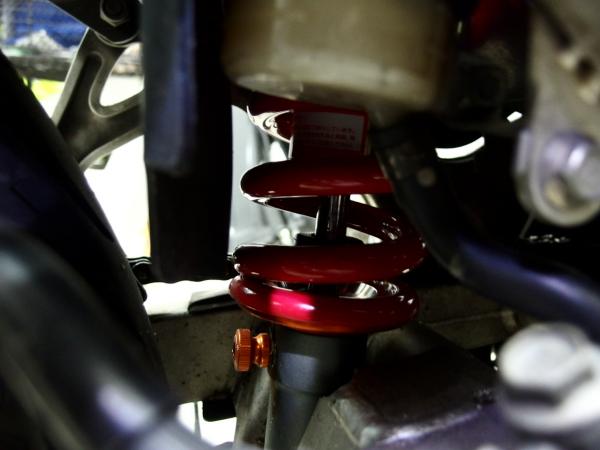

raider absorber oil seal broke causing oil leak and become soft

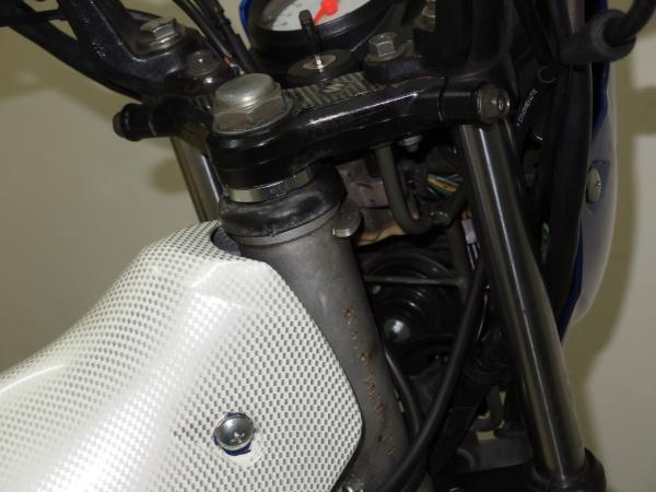

bearing handle spoilt
12058km means 112,058km
10/2/16
Kang Soon spare part shop
Racing Boy RCB absorber RM286 incl. gst
red color F/S/R setting
bearing handle

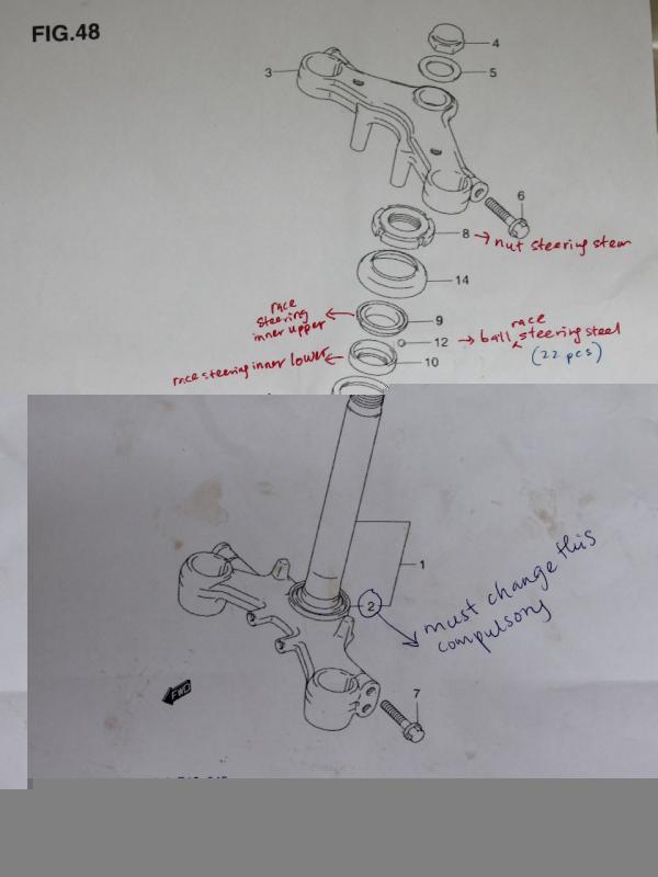

change one set exclude item no.2 RACE STEERING OUTER LOWER - the part is available correct part number but wrong size from made in japan so could not change.
changed
NUT,STEERING STEM
RACE STEERING INNER UPPER
RACE STEERING INNER LOWER
RACE,STEERING OUTER UPPER
BALL RACE 50pcs

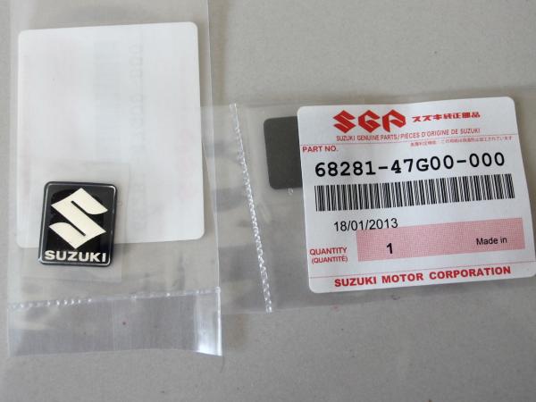

put new S logo on IU unit

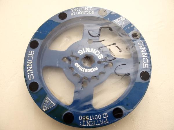

chain RK ring 428KLO
sprocket front/rear sinnob blue
change rear wheel sprocket rubber hub ( genuine suzuki )
rear wheel sprocket hub bearing Koyo

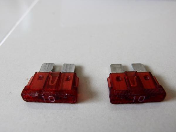

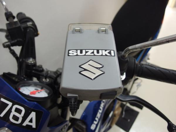

this is FU 150 raider R fuse 10A I got two extra for future use

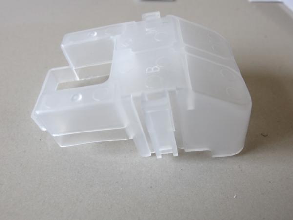

relay box new cover which is mild transparent

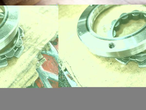

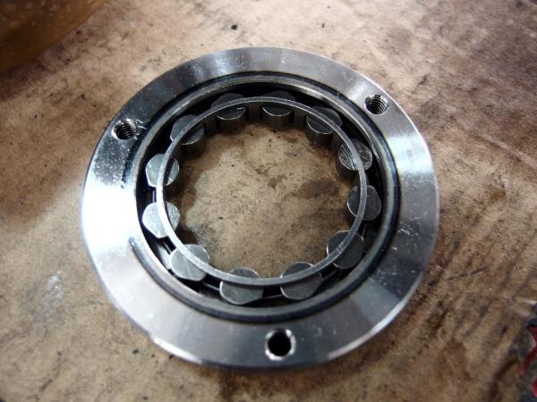

good lesson to learn
got from engineer of the bike
for all of us to learn
since raider r in spore are at high mileage

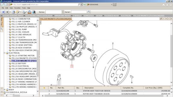

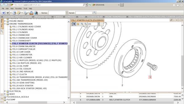

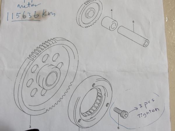

raider R uses a 3-phase generator. For units with high mileage, 1 or more of the 3 lighting coils may eventually give way and lead to dimming of headlight.
The other part to pay attention is the starter clutch bolts. There are 3 pcs. Over long time of usage, the bolts may become loosen and may cause damage to the coils of the generator. if there is abnormally loud noise when you switch OFF the engine, you need to get the bolts checked to see if they are securely tightened.
my opinion
hand tight will do , do not force machine tight
10 n-m
1.0 kg-m
I suppose

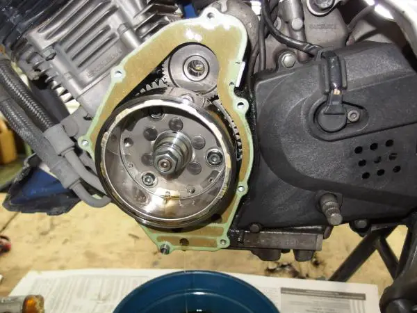

SC
starter clutch 3 bolts tighten

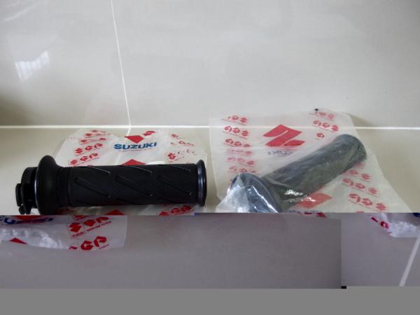

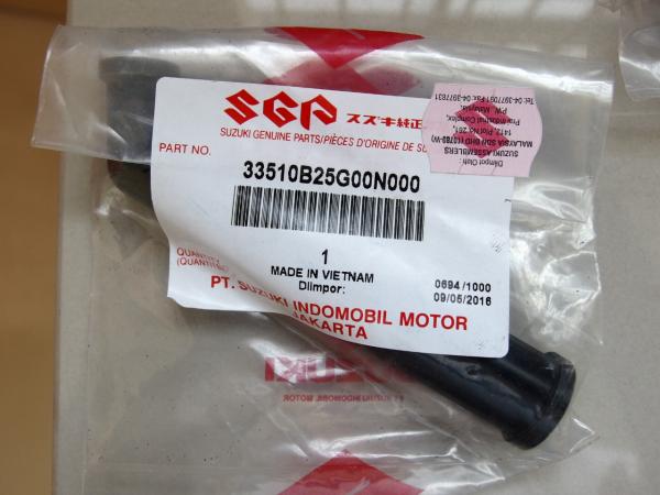

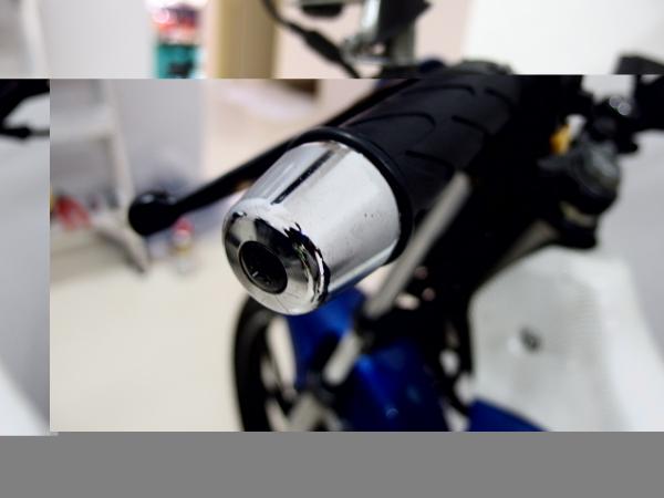

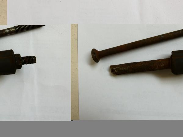

changed GRIP COMP THROTTLE and GRIP L
inside handle bar cleaned rust and changed internal components of BALANCER HANDLEBAR
spacer expander 2pcs RM7.40
screw handle balancer 2 pcs RM3.40
expander hdl balancer inner rubber 2 pcs RM2.20
sticker 'S' RM5
arranged headlamp wiring
insulation tape for wiring
pictures self explanation

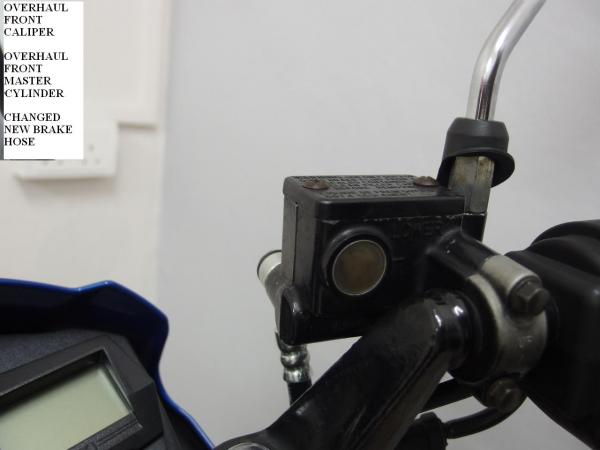

17 June 2016
meter 16283km means 116,283km

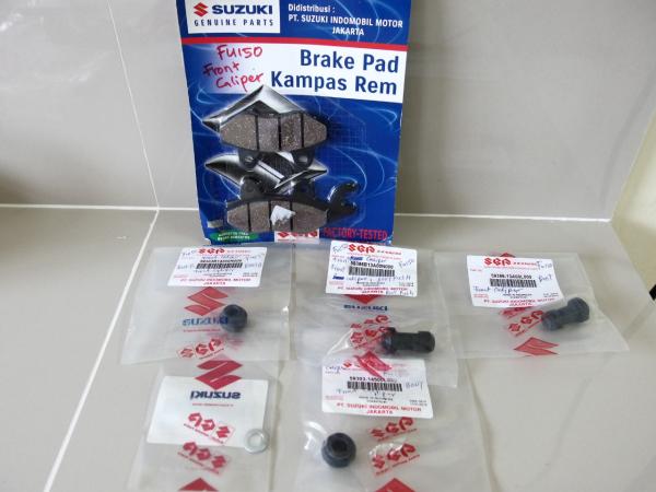

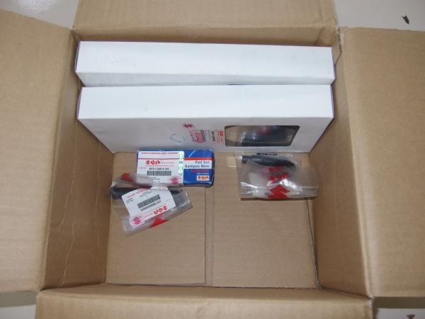

overhaul FRONT CALIPER
overhaul Master cylinder
changed brake hose

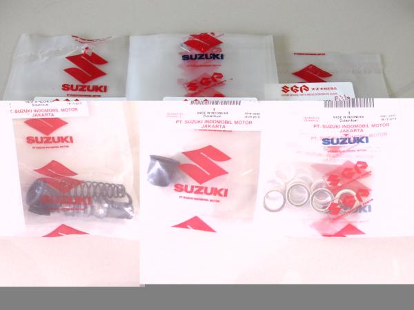

front disc caliper, changed
Seal set piston 4 pcs
WASHER SPRING
BOOT B
BOOT PUSH
Changed PISTON CUP SET inside master cylinder
Changed new brake hose design G20
new brake hose design 59480B25G20N000
bigger hole and more fluid kept inside hose

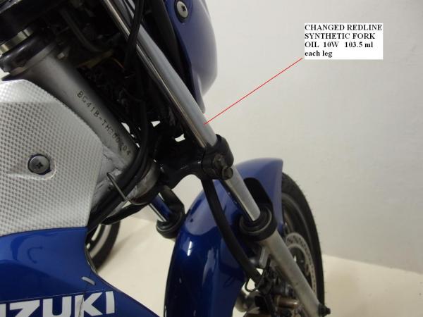

redline fork oil 10w
shell R4 1050ml

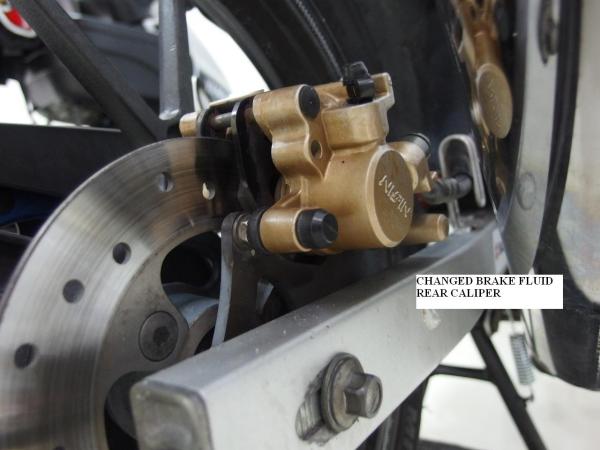

DOT 4 caltex brake fluid both front / rear disc calipers
Air filter Red color G20 new design
fix extra new clamp rr rsvr new design G10 for rear brake hose
add sponge for anti-vibration on headlamp cover

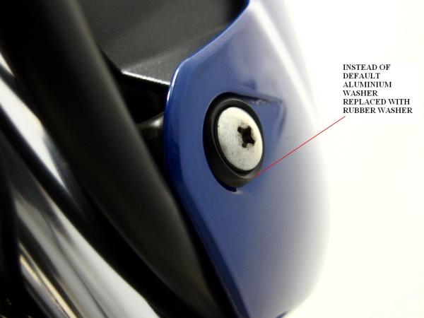

add front headlamp cover screww new rubber washer instead of default factory aluminium washer.

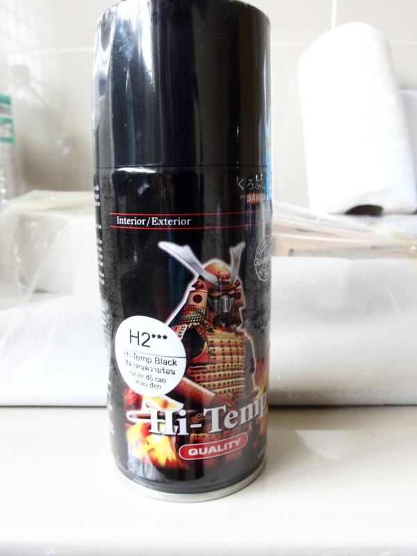

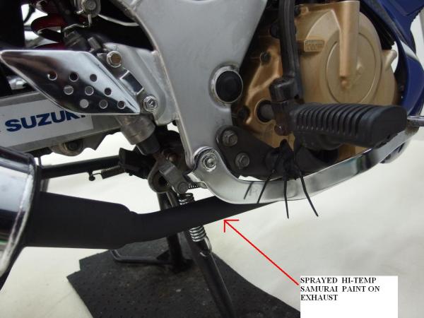

spray exhaust hi-temp paint samurai brand

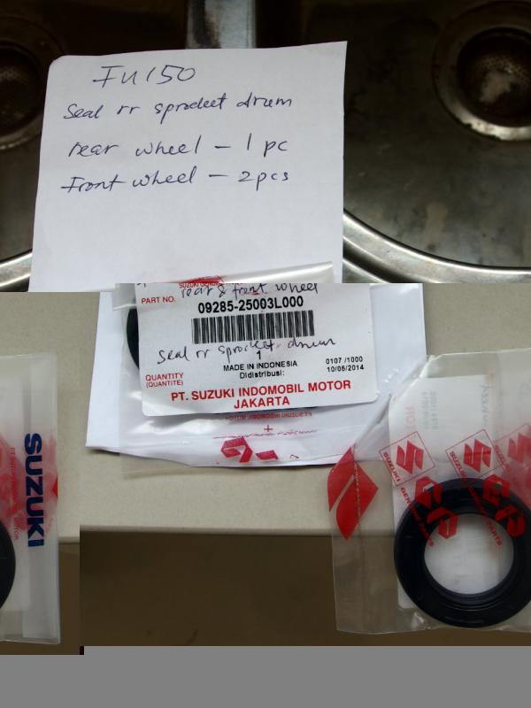

front wheel changed both side " seal rr ". Used pennzoil premium wheel red grease

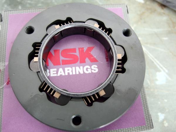

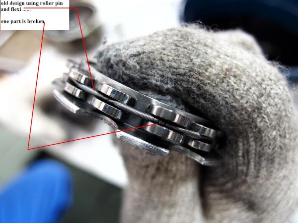

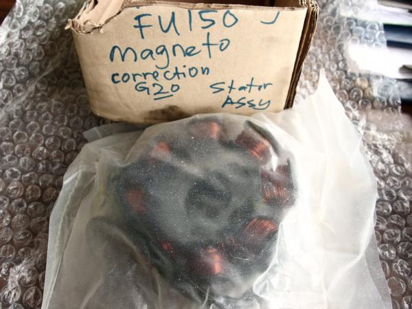

23 june 2016
meter 16550km means 116550km

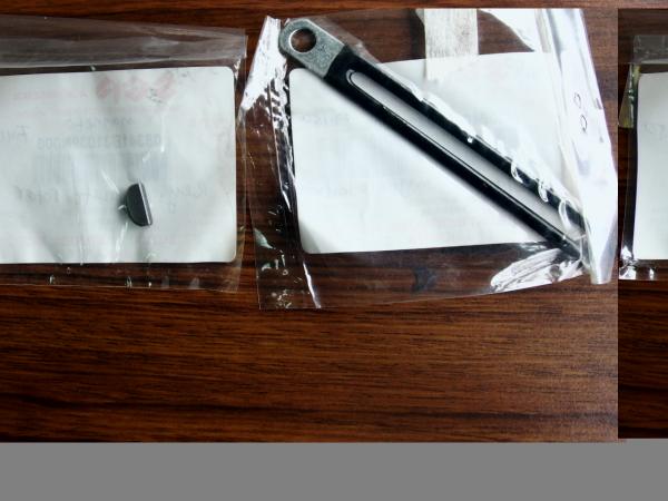

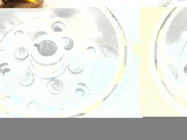

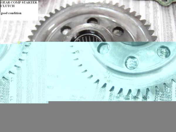

read above this thread forum I attached diagram on stater clutch and description on failure symptoms
changed "starter clutch one way". New design FL125FS-J made in December 2015 made in Thailand.
malaysian catalogue new part number is 1261425G00-000.
RM154
engineer said this part has been changed entirely.

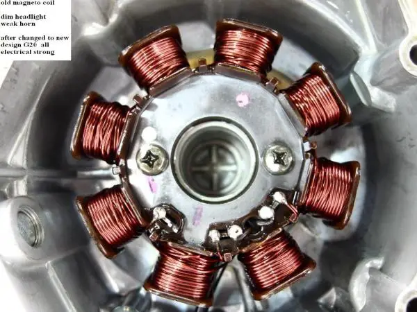

changed magneto coil new design G20
changed gasket magneto cover fxr 150
changed CLAMP magneto lead wire

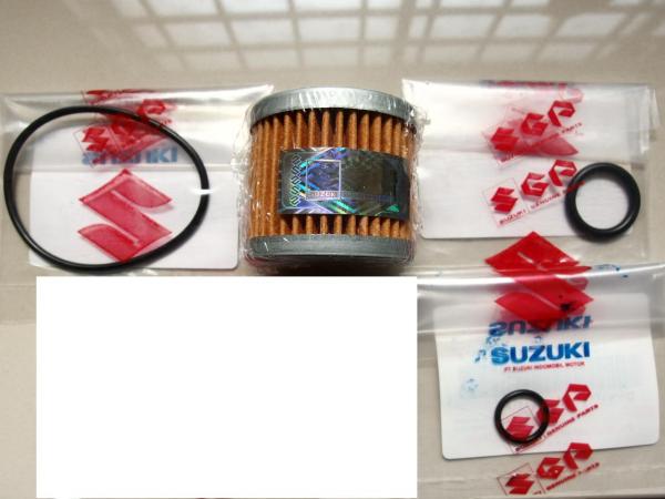

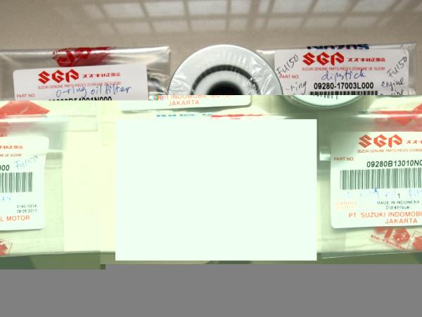

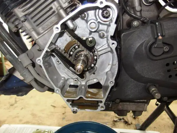

changed all o-ring for oil sump
oil filter cover o-ring
oil filter o-ring
dipstik engine oil fill o-ring
changed oil shell R4 with oil filter 1150ml

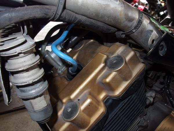

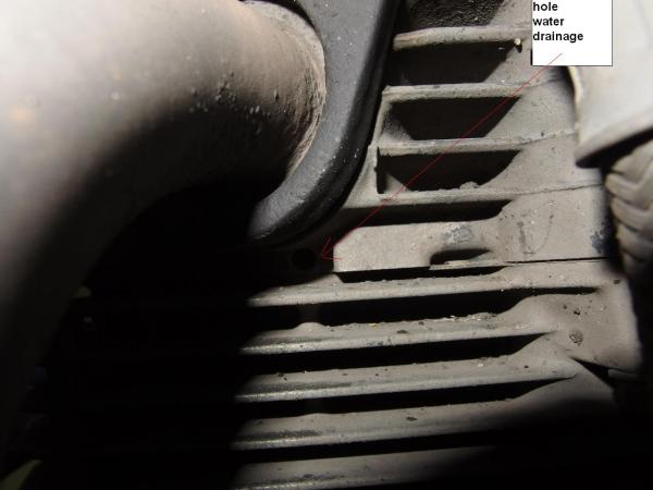

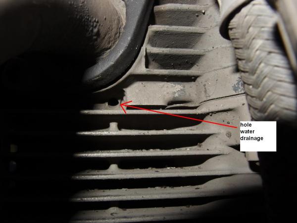

there is tiny hole below exhaust pipe hole
this tiny hole must be clean always
spray direct air into the hole and keep it clean or else when rain water enter plug hole it will not drain out

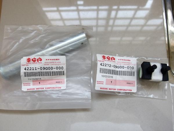

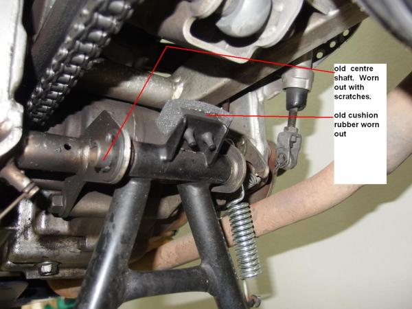

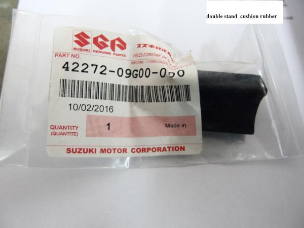

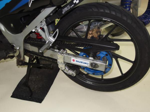

20 July 2016 16,985km
changed shaft inside double stand due to worn out and mild shaky double stand.
42211B20G00N000 SHAFT CENTER STAND
42272B09G00N000 CUSHION CENTER STAND
long time ago changed spring and centre stand new design G20

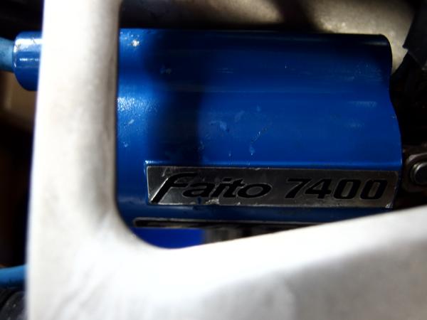

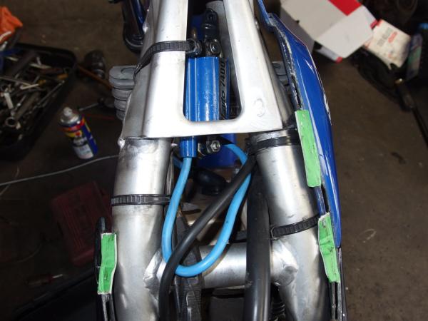

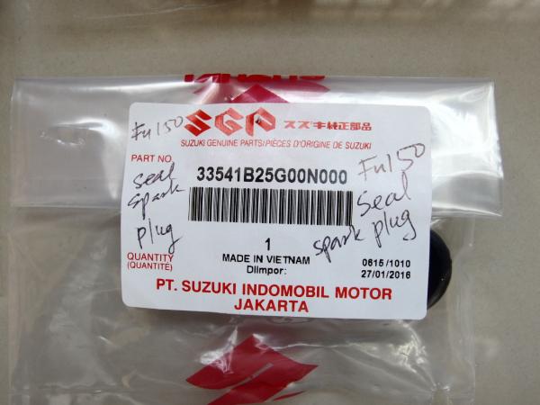

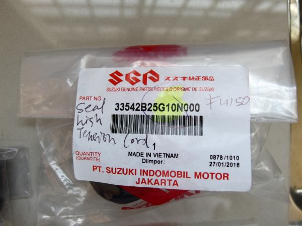

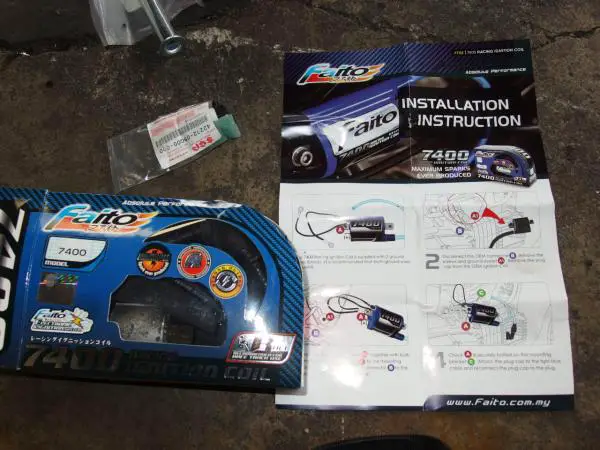

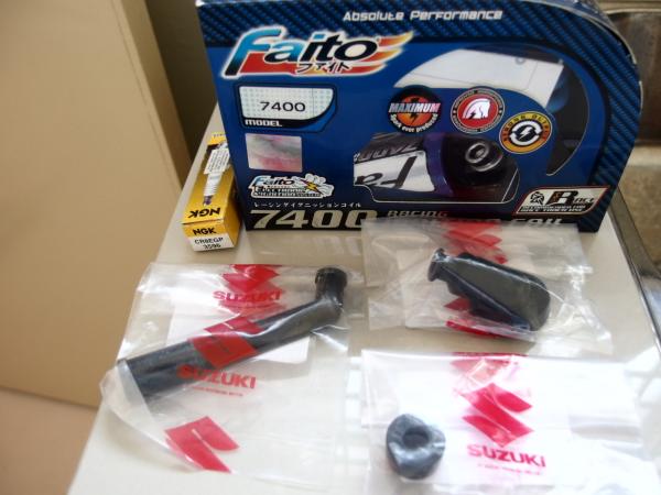

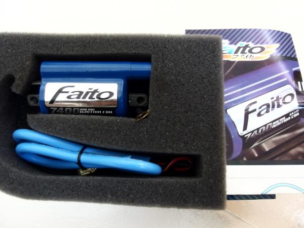

symtoms
heavy rain bike getting stalled
found out the plug cap is wet and ignition stops
after 11 years first time changing whole set
changed FAITO 7400 ignition coil RM75
changed high tension cord - 2nd time changing
changed plug cap RM50
changed cap seal
see photos of tiny hole (above in this page)
Edited by gunshead
Thank you very much for your kindness consideration. By God's Grace.
Please consider the environment before printing this e-mail; Save trees
www.heritagebaptist.org
www.worldvision.org
www.cfcindia.com
http://www.e-sword.net/downloads.html free God's Word
more photos to support above writing
after fixing faito 7400 i tested
result:
1. super smooth acceleration
2. need open little throttle the bike will move very fast
3. believe will consume low petrol as power is adequate with little throttle
4. one press electric start bike ignite fast.

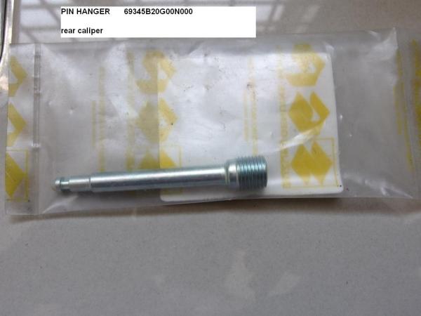

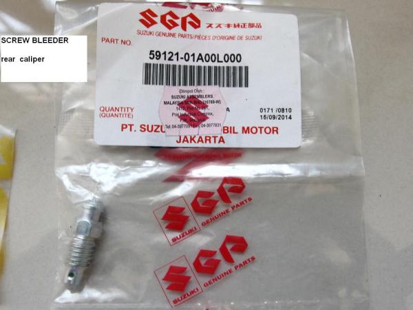

check your disc caliper
if pin hangar and screw bleeder is rusty
pls change them
otherwise when u bleed brake fluis it is not smooth
clean screw bleeder witll drain out brake fluid easily
therefore u get to do changing brake fluid faster and efficient
