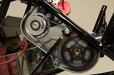

The real world solution, a custom make gear box just for bikes,
http://thekneeslider.com/archives/2010/03/18/reverse-gearbox-for-motorcycle-powered-cars-from-roadstercycle/
The suggested alternative solution, electric drive to reverse the gear, via belt drive to the gear cog. But mine is shaft, haiz, have to open this gear box and link to rear wheel.
