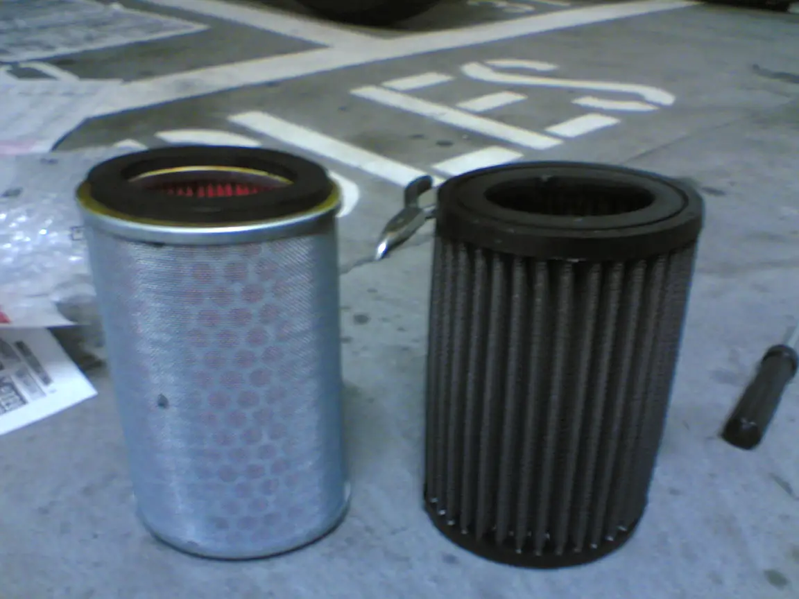

Guest quizesilver
the mesh of knn filter is bigger as it is made of sponge
whereas oem filter are make of paper like material
which explain the higher flow rate. also knn make use of the oil to trap the dust etc which is why u need to clean is too
for those bros who are curious, take a look at the pic i attached.
it's an oem air filter and a KNN air filter...side by side...
color=red]For our sins.........................HooAH[/color]
mudman: Thks bro! Great pic over there. I've not seen any OEM or K&N air filters before, coz I got a K&N air filter fixed on before collecting my bike from shop. Hmm.. Seems as though OEM air filter has a better design? =P
Regards
sky_vinz
i like the fact that a lot of the dust from the road is being trapped inside the OEM filter bro , will take a pic of the used OEM filter tonite and show u. i have never changed my filter since i got my bike in aug 05 and i am amazed at how clean and dry the whole chamber is ........=)
mind u, that pic of the dirty K&N filter by mudman is actually from the spec 1 i just bght recently... :cheeky:

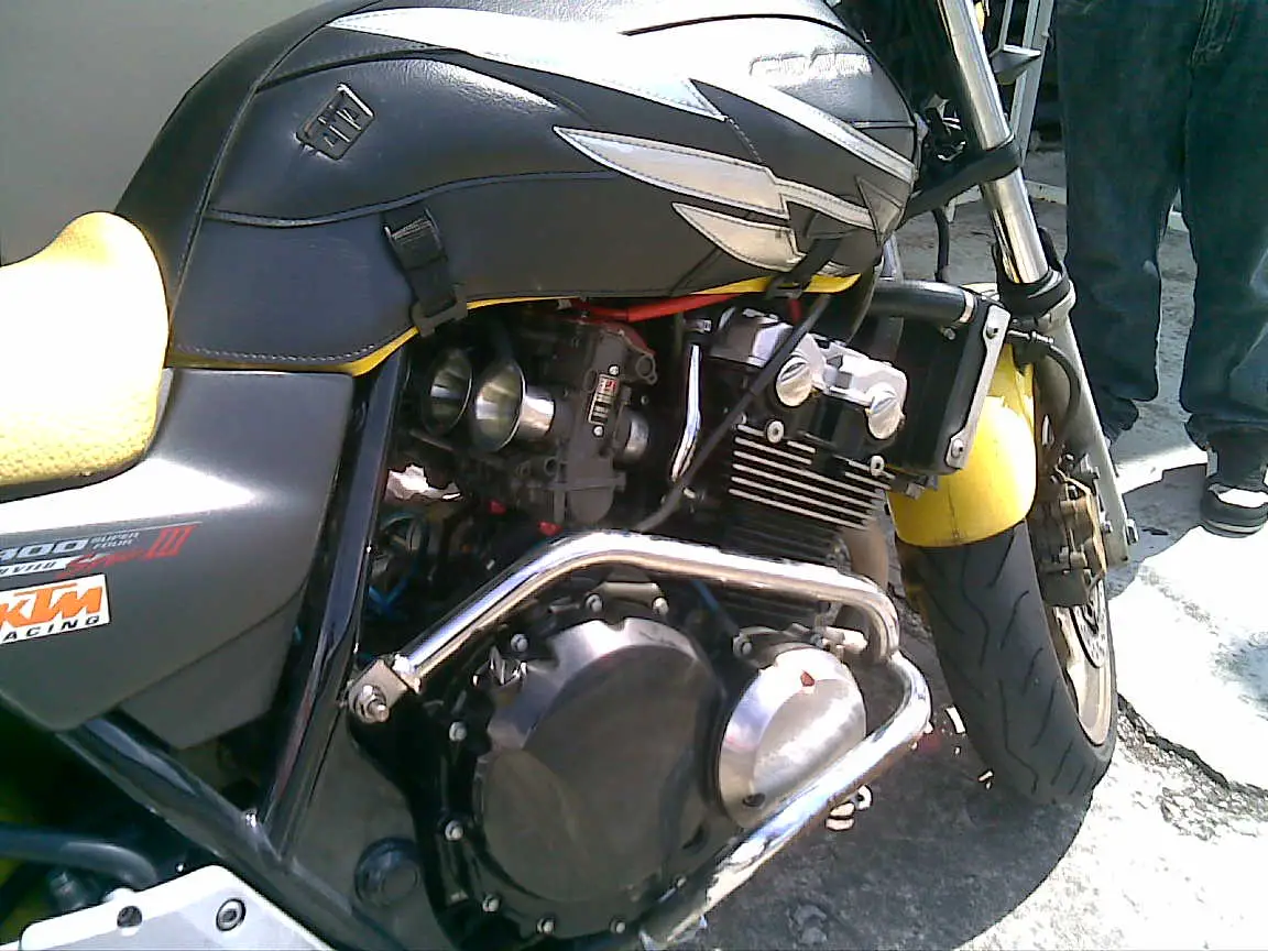

Hi bros, have u all see a pic of a super4 spc 1 or 2 that never use air box just using air filter? really can dun use ar? if rain how? must be powerful with out air box... :cheeky:
NSR 150
Super4 Spec2
Super4 Revo
http://bp3.blogger.com/_TO9Sh3u5Vzk/RlLq5GS_F9I/AAAAAAAAAFU/IsyInHRbfcQ/s400/Traffic+Police+GTR.jpg
not they don wanna use cos cant use... fcr and yoshi carb is an open pod air intake... cannot fit our air box soo use open pod air filter....
http://i156.photobucket.com/albums/t28/Sonicgear85/54.jpg http://i239.photobucket.com/albums/ff205/evoaiwa/qw.jpg
