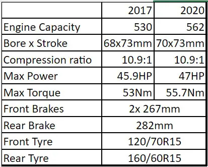

Visual difference between Gen 6's Tmax 530 and Tmax 560;
New Front LED Signal Light, New Rear Side Panel Design (for passenger's leg comfort), New Brake Light Design, Improved Rear Shock.
Internal Differences are better engine cooling, better transmission ratios, separable Throttle Body.

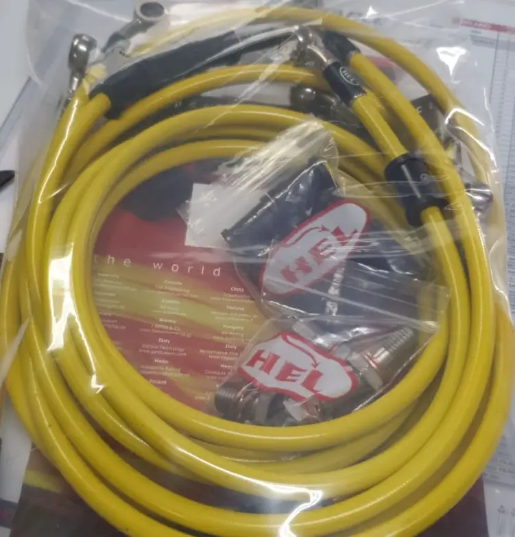

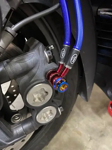

Stainless steel brakehoses
One of the easiest upgrade to have a better feel. Most Japanese bikes still comes with rubber hoses from factory to keep the manufacture costs down. These hoses based on manual are to replace every 4 years. I personally replaced them at 3 years' mark, I take it as an upgrade together with replacement. There's no meaning to replace them back to factory rubber hoses. being said that many Tmax out there are still on their stock rubber hoses and running fine. It's a good upgrade, hoses are not expensive, however the labour costs are.  You will be looking at about $550 for this job.
Changing these hoses not just a maintenance upgrade/replacement but it's also a aesthetics upgrade too.
See the coloured banjos and banjo nut!!

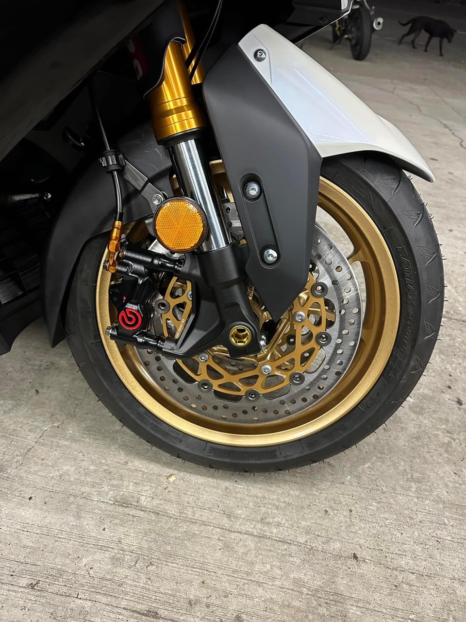

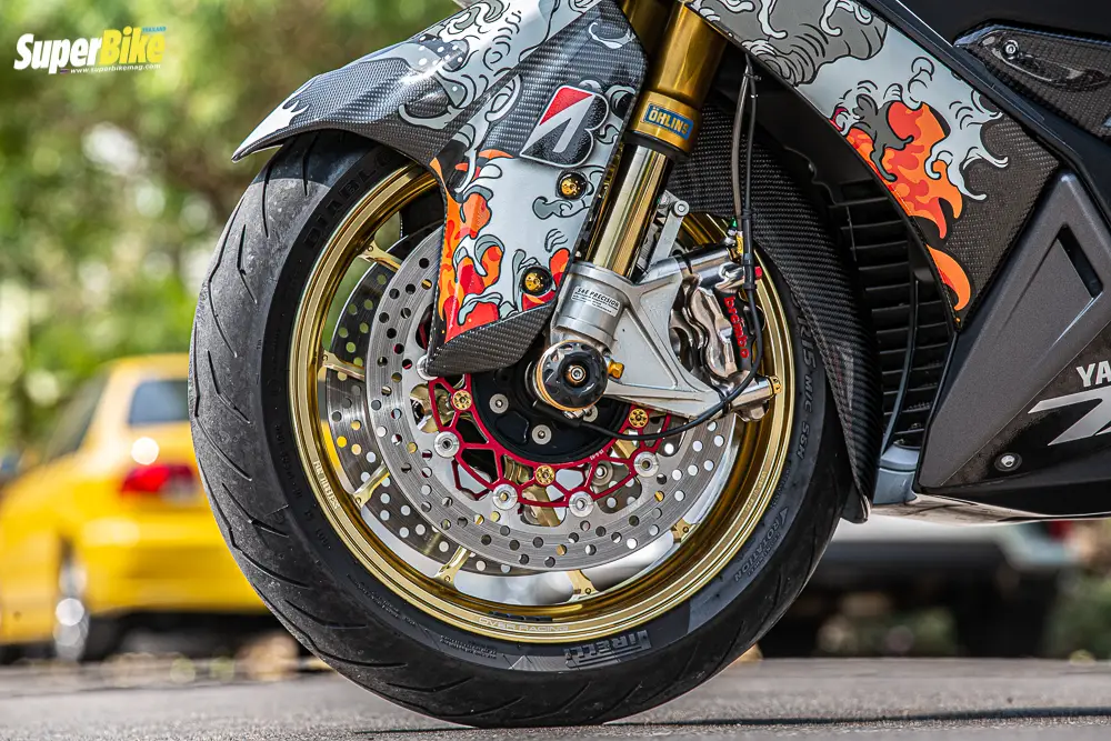

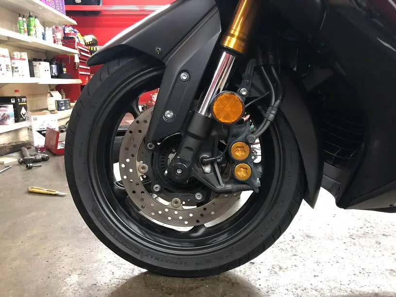

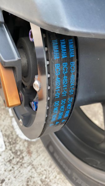

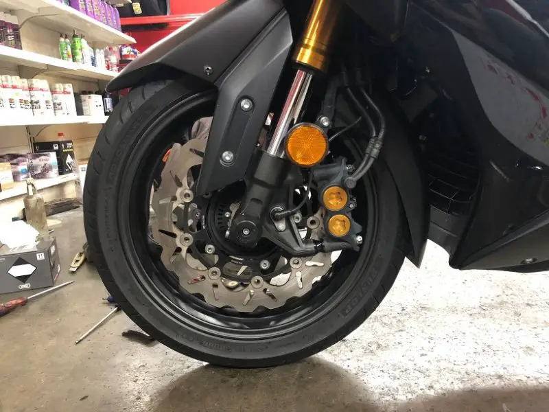

Brake Rotors

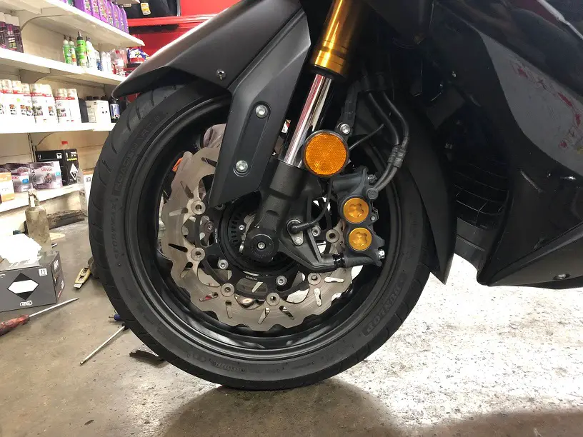

Tmax comes with 267mm diameter dual front brake rotors.  Another easy way to upgrade is to change to a bigger rotor. This upgrade is easy due to the radial mounted calipers. Simple physics in this upgrade, bigger rotor needs less effort to brake.
Normally it's upgraded to a 300mm rotor, spacers are needed to "push" the calipers out to accommodate the enlarged rotor. In this case, a 16mm spacer is needed.
IMG_6282.thumb.jpg.24b5d4b084a84bccf7c9e9b44bf78041.jpg IMG_6287.thumb.jpg.fed91cd7961be004088a1df4fca4e048.jpg
As attached photos, you can see that the aftermarket rotors are significantly bigger. This is also one of the easiest way to upgrade your braking system. I'm using Galfer rotors and they are great in term of performance and looks.
Brake Calipers

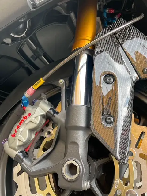

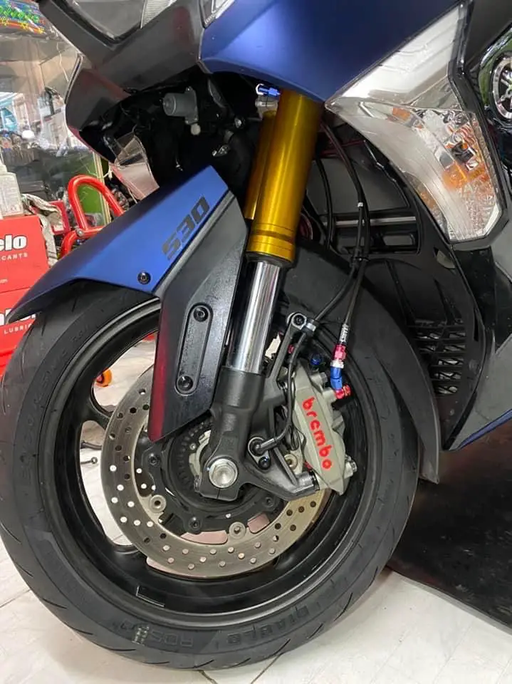

Calipers upgrades are one of the ways to get a better brake feel and at the same time bling up your Tmax. However, do note that changing to aftermarket calipers will need to have proper spacers to stack up as these aftermarket calipers do not have the same mounting axis as OEM calipers. Do take a look at the below photos for the spacers differences.
Let's see some of the calipers upgrades from all over the world.
Brembo M4 is a pair of very popular calipers among Tmax riders. However it had to be paired with RCS to give a firm feel at the levers.
Brembo GP4RS is the improved and newer M4. They weighed lesser and have better cooling capabilities due to the cutting of the calipers. The pistons are also same as OEM calipers, brake feel will be similar to OEM calipers. Not necessary to change brake pump in this case.
Brembo GP4RX are higher grade of the GP4 series. However, change of brake pump is needed as these set of calipers have significantly bigger pistons and will give a very soft brake lever feel.
Brembo .484 calipers are very popular in Taiwan and they also hold a premium value and are the only calipers that comes in piano black. They costs about the same value as GP4RX.
Of course there are better and more expensive options in the GP4 series such as RB, RR, LM which can be quite daunting to an average SG biker.

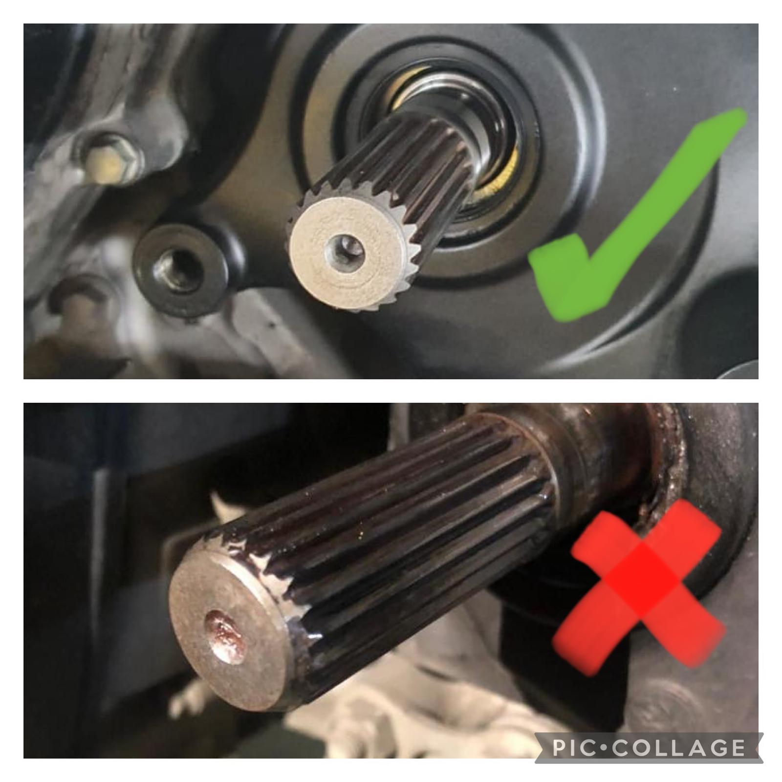

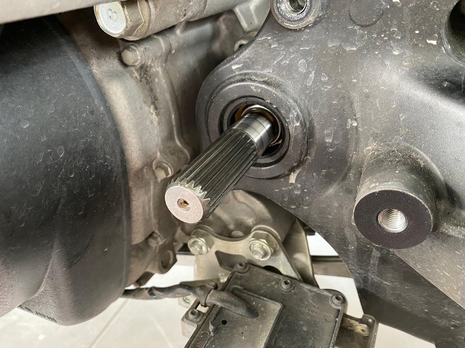

Primary Pulley Greasing
Some of you had PM me asking me why should we use the proper grease for our primary pulley.. let me explain in detail..
  1. This Yamaha Grease J is specially formulated for penetration and will turn lower viscosity when heated.. our primary pulley will be very hot once you start rolling.. then will penetrate the gearing teeth to lubricate and remove heat..
  2. the high temp blue grease that most of you think that's working, will not turn into lower viscosity fluid like Grease J during high temperature.. it will just be centrifuged out, thus the blue grease wouldn't be able to lubricate the inner gears teeth of the primary pulley..
  3. The blue grease not only will not lubricate the primary pulley, it will cause the shaft to get rusty and thus making it shear on its own gears.. the replacement is a easy $2k for the shop as the engine needs to be tear apart to change out the primary shaft.
  4. Agent is charging $120 for greasing service, and another $40-60 for cleaning out that wrong grease u using..
  5. Do not use other grease except for Yamaha Grease J!! Some shops use similar brown grease but does not have the same function at all..
  6. Greasing should be done as a maintenance job yearly due to our SG climate as water and heat will wear the grease.

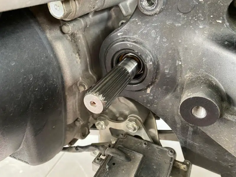

Attached video is showing the primary shaft that's badly damaged by using the blue grease (blue grease had been cleaned out), pay attention to the sharp teeth..
Attached photo is showing a primary shaft that's on Grease J and the primary pulley being detached without any cleaning done yet! notice the gear teeth are not sharp..
This last photo shows a comparison between the good teeth and the sharpened bad teeth..
feel free to PM me if any of you need a greasing good time..

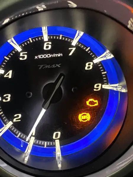

Engine Check Light (ECL) issues
One of the most common issue is the O2 (Oxygen) Sensor, the other issue will be the wheel sensor.
Scenario can reset
1. Forget connect O2 sensor during CVT change
2. O2 sensor dirty (stuck lean)
3. Error reading
Scenario cannot reset
1. Broken circuitry (due to heat)
2. Wires broke during CVT change
With ECL lighted up, there's no way to go into menu at all for Gen 6 and above models.
Not all shops have the diagnostic tool to erase the ECL.
Most of the time, the replacement of the O2 sensor will solve the problem.
HL is selling the new sensor at $240 without GST and installation..
Hit me up if you have this problem, I have a cheaper option and have the tool to reset the fault code.

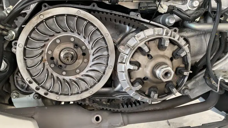

CVT/Torque Driver Issues and upgrades
Do religiously maintain your CVT as the V belt can break from over usage.
Recommended mileage is 20,000km (12,500miles)
These broken belt not only will spoilt your day but may also do some damage to your CVT components.
As these vbelts broke, they will scratch the smooth surfaces of your CVT components, inevitably may cause some weird sounds when your new vbelt goes over that area; worse will be premature wear and tear of your vbelt. Therefore, it is very important to take care of your CVT servicings.

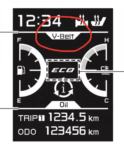

Most scooters will have the V belt indicators lighted up when the mileage is reached.

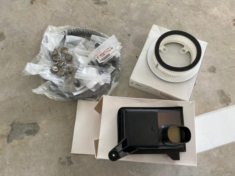

Before this indicator lighted up, you should have prepare the consumables for your CVT servicing.
If you are using stock variator, the following are needed:
  1. V belt (Different years will have different part numbers)
  2. Rollers aka weights (Different years will have different part numbers depicting different weight)
  3. U-clips aka sliders (same thru out all 530 to 560 models)
  4. Right side Round filter (same thru out 530 to 560 models)

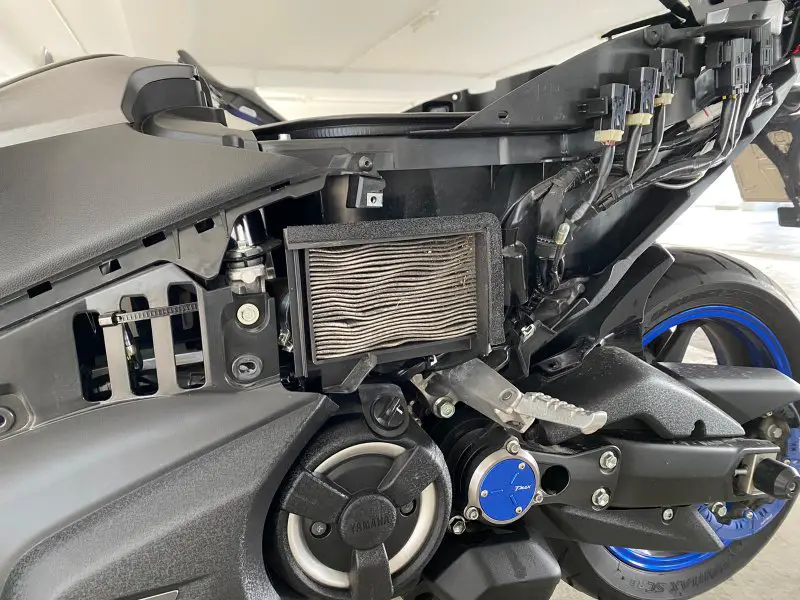

  5. Left side square filter (2012-2016 are different from this attached photo, 2017 till 2021 is the same, 8th Gen is totally different)

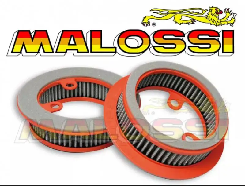

The left and right filters are commonly left out, these 2 filters gets quite dirty.
Above photo shows the left side CVT filter. This side there's no reusable one, this piece costs $40 without GST.
However the right side round piece have after market one that washable and reusable. This filter have minimal performance indication, the purpose for these filters are just to cool down your CVT and prevent debris from going in.
Costing $40 for OEM, it's definitely economical to buy this Malossi one at about $80..

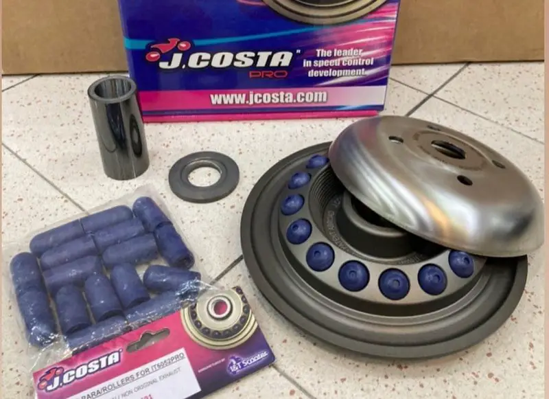

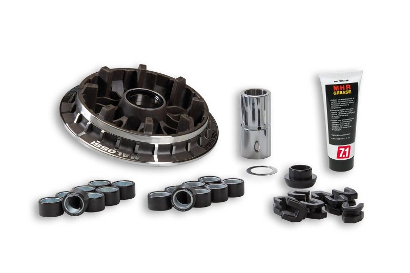

Aftermarket Variators
Currently to my knowledge, there's Jcosta, Malossi and Polini in the market for 530 and 560.
1354520846_Malossivariator.thumb.jpeg.1d8f76f4a1bff0ee76d75334cf5b03e0.jpeg1958722410_Polinivariator.jpeg.31c8d348220726458e24efdf6bde3497.jpegJcosta.thumb.jpeg.40ea0ceed252d1149ebfba3720a828d1.jpeg
Each of these variators worked slightly differently from each other and to the stock variator.
Basically an aftermarket variator changes the speed and time duration to your 0-100kph acceleration in short. When using aftermarket variator do take note of the need of its consumables and the type of belt needed. Some variators need to use their own brand specific belt, some can use back your OEM belt.
For money saving tactic, I would suggest to change your variator to aftermarket kit during your CVT servicing; not only you get a new reset of the vbelt, you get to feel the difference between OEM and aftermarket variator without wasting extra money for installation.

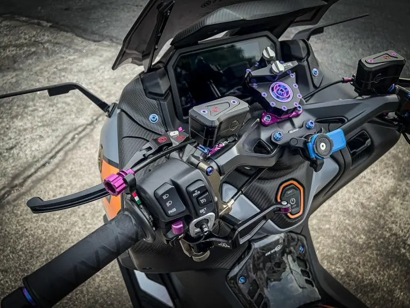

Aesthetics upgrades
There's a few well known brands in this department, namely:
  1. Gilles Tooling (Official accessory)
  2. Rizoma
  3. Lightech
  4. Deprettomotto
  5. BCD
  6. Evotech
  7. Puig
  8. Aliexpress/ China replicas
Each brand have their own accessories and good in their own design. Do your own research or ask me during meetup for each of its good and/or bad.

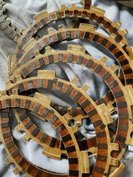

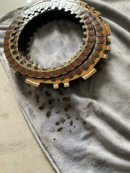

Clutch issues and upgrades
Although Tmax is classed and advertised as a scooter, but its clutch functions are almost as similar to any other manual shift bikes, using wet clutch plates; instead of being actuated by cable/hydraulic clutch lever, it engages by using centrifugal forces.

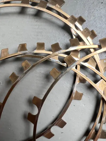

Therefore clutch plates maintenance is essential and by far had costed many Tmax owners shocking bills and wastage of time when their Tmax had worn clutch plates.

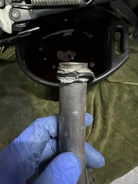

Back before the revision and update of a newer OEM clutch plates, before year 2020 OEM clutch plates had the tendency of their friction materials dropping out from the clutch plates prematurely and ultimately caused an overhaul job due to stuck friction material stuck inside the strainer causing a block in the upstream lubrication.
This blockage can be easily diagnosed by looking at the oil window, and if it's similar to the attached video means the oil passage had been blocked by friction materials.
oil not flowing.MOV

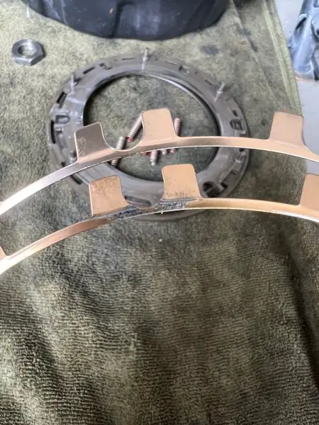

Below are some photos of the dropped friction materials.
bits.thumb.jpg.962e975a0ce7baebe45ba52c566afbab.jpgbits2.thumb.jpg.9a50a50578a044ec24d8a05ec584b227.jpg

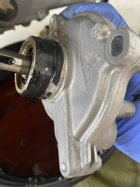

Some shops reused the o-rings that was supposed to be changed with every clutch service. but they realised the coolant will leak, hence slapped copious amount of silicone on the water pump and pipes to prevent the leakage.
361429293_waterpump.thumb.jpg.e5f80f52b4eb615313a63cec4a916686.jpgwater1.thumb.jpg.740e91ac00863d63067ff8a2ba8fb2dd.jpgwater2.thumb.jpg.43adfa76ab27ace01651c8b5fd044552.jpg
After the 7th Gen Tmax was introduced, Yamaha revamped and improved their clutch plates. Hence, such cases will be rare unless your Tmax is still using old clutch plates.

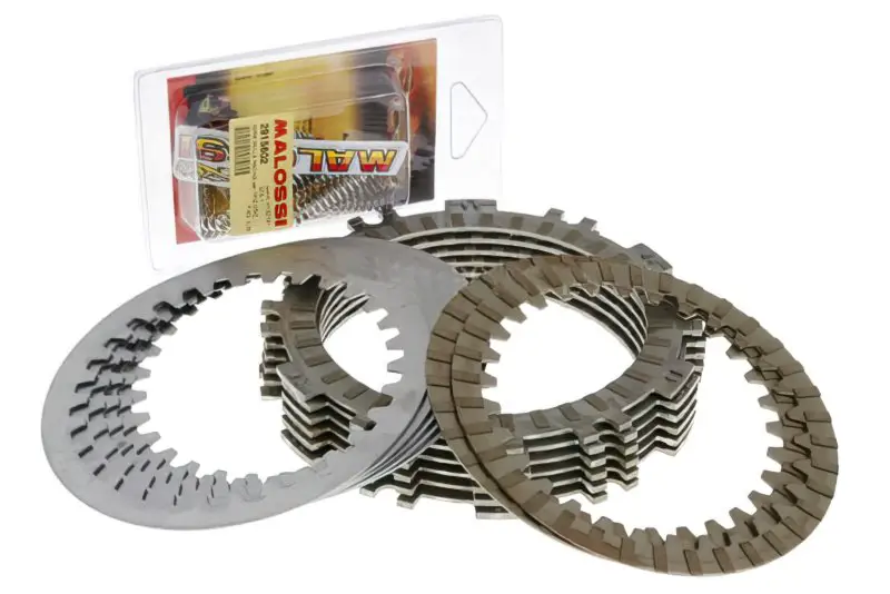

Malossi Clutch Plates
A widely used replacement before Yamaha revamp the new clutch plates. Current retail price is about $250. Buying this set of clutch plates comes with the clutch springs that can be used to change the engagement RPM.

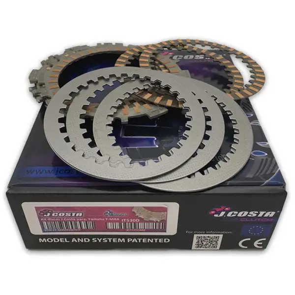

Jcosta Clutch Plates and Housing
j.costa-yamaha-tmax-it530d-clutch-discs-kit.thumb.jpg.0d1e5dff0ec9f626419a828cd3da5353.jpg1023431826_jcostaclutchbasket.thumb.jpg.c8d09c7ca11ad6008ec1b0171e65f0a8.jpg
A newer brand in the market compared to Malossi. The retail price is also about $250. Jcosta also had a clutch basket that works similarly to its variator. Similar "bullet" style clutch using centrifugal forces to engage the clutch instead of clutch springs.
Jcosta clutch basket will give you that initial pull during the moment the bullets shoots out.

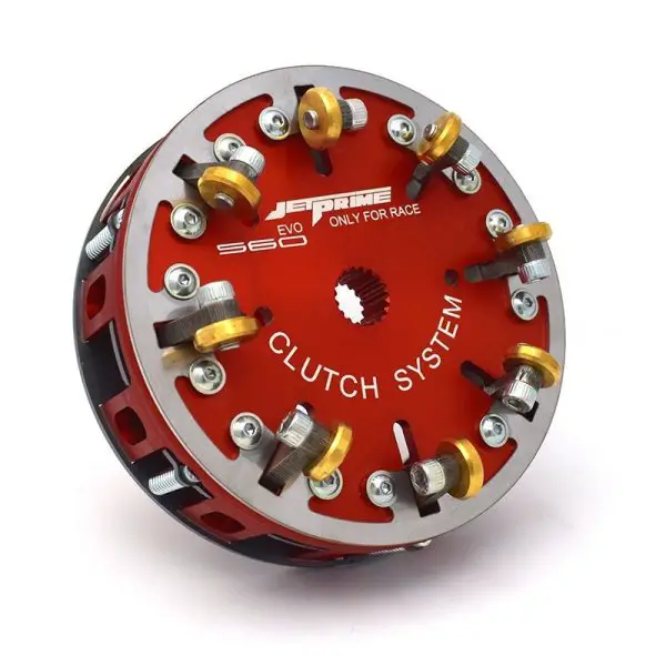

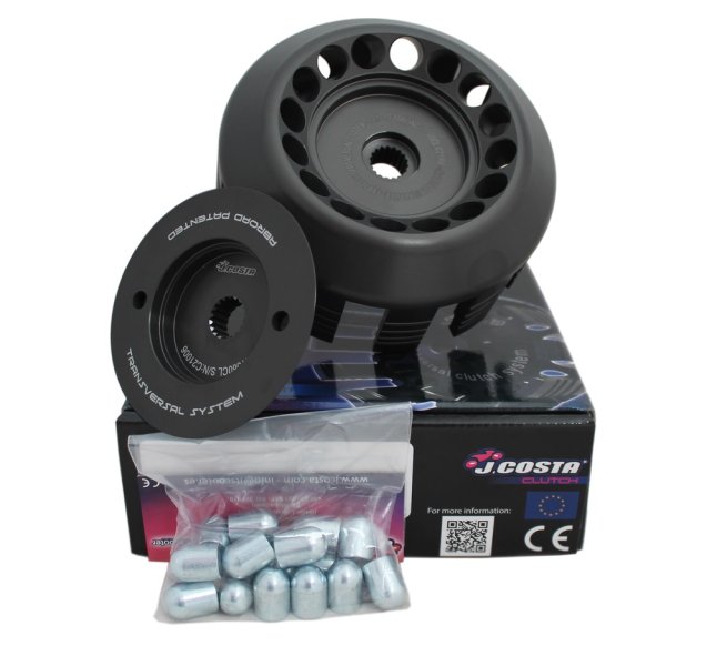

Jetprime Clutch Housing
lightweight-racing-clutch-for-yamaha-t-max-560.thumb.jpg.fe9c0296178de5cf3ee7e6e4b6e86f99.jpg
Jetprime is a experienced maker in scooter market. It also had a unique working style clutch basket to replace the OEM one. Its "Hammer" style clutch basket may shock user in the initial running in stage, but after running in for a while, the clutch basket offer lesser engine brake. This clutch basket also uses 1 lesser clutch plate and 1 lesser metal plate.

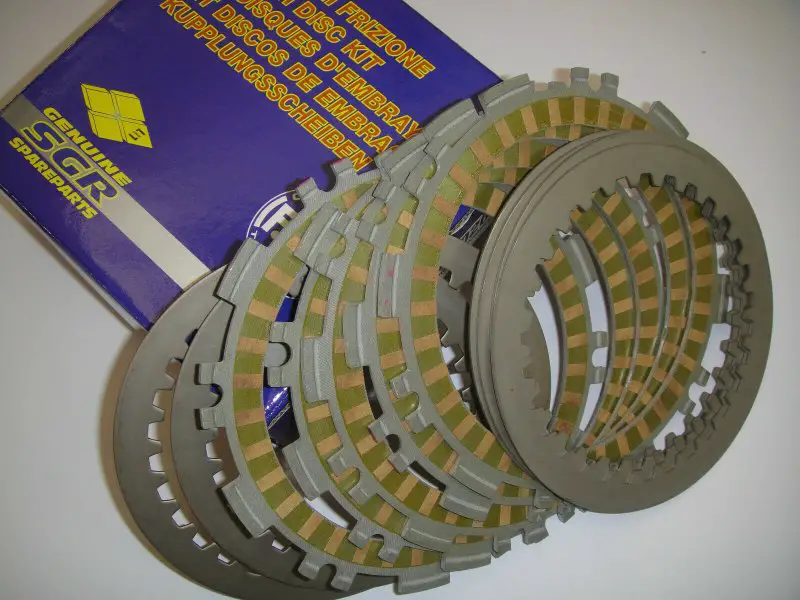

FCC Clutch Plate
A very common replacement clutch plates available in HK and TW before Yamaha revamp its clutch plates.
Do note that most of these clutch plates and clutch baskets are advertised as racing use and aftermarket performance product. Therefore, it's normal for them to have shorter lifespan. Clutch basket is also a consumable if your Tmax have high mileage.

Worn out springs will cause some weird sounds during idling and may cause premature wear of your new clutch plates due to the worn thickness. Below is a photo to compare a new one and a worn one.
Clutch baskets are also wear and tear part if your Tmax is a high mileage one. Although due to oil lubrication in the clutch area, springs and clutch basket are normally subjected to lesser wear and tear but when user over used the clutch, the allowance limits within the springs and clutch basket will wear down.

This below photo shows the newer version of the drive belt.
Old vbelt had all RED fonts, new belt will have BLUE and RED fonts, or you can check the serial number as below.

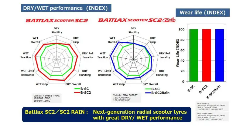

Tyres
There are few brands of scooter tyres for Tmax to use.
  • Bridgestone SC2 (comes with new 2022 Tmax)
  • Michelin PR4
  • Pirelli Rosso
Bridgestone SC2 and SC2 Rain
Michelin PR4
Pirelli Rosso

Air filters and Intakes aka Velocity stack
Airfilters are commonly the first few things a biker will change to improve performance.
There's a few well known brands in this area such as K&N and BMC, however do not belittle Taiwan brands like Simota and Level 10.
bmc.jpg.38972ca004367aa1b9eff218e9b9715f.jpg10.jpg.bb98ec06ca3d16fe0838f686da7ede87.jpg
See the noticeable differences between BMC filter (left) and Level 10 filter (right).
Level 10 Filter had made its filter in a non conventional way to increase the surface area. By far, this brand of filter is the "go-to" in Tmax Realm.

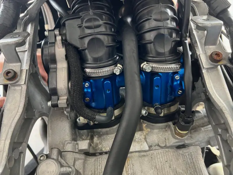

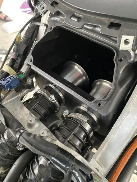

The velocity stacks are right after the air filters. Many sportsbikes owners would not be unfamiliar with this modification. Changing the velocity stacks will improve the airflow and changing the air/fuel ratio.
The following photo is an example of a 560 changing to aftermarket velocity stacks.

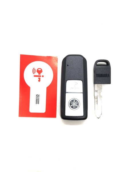

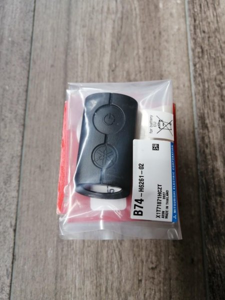

Spare key / FOB and activating emergency sequence
Starting from 2015 Tmax onwards, keyless on/off was the new feature. Key FOB (Frequency Operated Button) just need to be near the bike to operate. This convenience had bought many joy and sorrows to all Tmax riders till now.
These FOB comes with a set of 6 digit PIN that is your Tmax's PIN to pair new FOB or start emergency sequence; make sure you have this 6 digit PIN saved in a secure place when you buy a new Tmax, request this PIN from shop or seller if you buy 2nd hand Tmax. Without this PIN, you will not be able to pair new FOB or start emergency sequence in the event if you lose it.
If you have yet made any spare key or FOB, please go make spares after reading this post.
Having a spare key/ FOB can save you many troubles in the event of lost key/ FOB. I will cite a few real life examples of people losting their FOB, accidentally off it, placed in the top box etc.
2015-2016 Tmax key FOB looked as attached below.
2017 onwards Tmax key FOB looked as attached below.
Noted that the physical key that comes with it can be duplicated easy using normal Yamaha key blank as shown below. There's no more immobiliser chip inside the key hence just go keysmith to get it duplicated.
Tmax OEM FOB is very expensive costings in the $200+ region. However because the frequencies are similar to Xmax, you can always buy a Xmax FOB to duplicate. Not only Xmax FOB is cheaper, it's also smaller than Tmax FOB. Only downside of this XMax FOB is that the premium looks of the nice Tmax FOB isn't there any more.
In the event of lost FOB, you will need your key to open the seat to activate the emergency sequence. Therefore, it is more sensible to keep the physical key separated from the FOB. Tmax till 2021 will need the physical key to open your seat for the emergency sequence; whereas 2022 Tmax onwards do not need the physical key anymore.
Good luck if you lost your FOB and key, and not having your PIN. The painful way is to buy the CCU and change the key lock which comes up to about $2K plus from agent.
But all is not lost, there are some experts in this field that are able to recode your CCU. Just pray that you will not come to this stage.
So, do keep your key and FOB properly. And your 6 digit PIN too. If you are selling/ buying Tmax, make sure to provide/ ask for this 6 digit PIN too.

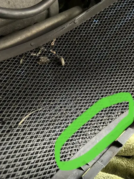

Radiator Guard
One of the first few accessories for a new bike is definitely a radiator protector. But for Tmax, I strongly urge anyone not to buy any radiator guards. Without the guard, the radiator will be free flowing and will have minimum debris. I have seen a 9 years old Tmax having a nice radiator.
This photo shows a radiator guard that traps debris, restricted air flow. Needless to say, the fins there is damaged.
I had done the same to my first Tmax, installing a radiator guard thinking that it will protect my radiator. But I will never do the same for my subsequent Tmax.

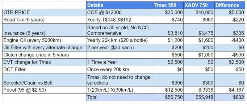

Comparison in owning a Tmax versus XADV Costs
Based on current $12000 COE and its average OTR prices.
Average of 20k km per year.
Most of the big ticket items are counted in. Sparkplugs value is the same as both have the same number of cylinders, thus not counted in.
Do bare in mind that XADV machine price is cheaper in other countries compared to Tmax.
XADV is more expensive in SG due to the ARF because of its capacity.
Hence, XADV is cheaper to own and maintain in other countries if compared with Tmax. But in SG, due to the initial prices, it is slightly higher to own a XADV.
Disclaimer: This is just a simple illustration to compare. It doesn't show real figures or actual prices.

Brakes Part 2
Part 2 on brakes: Let's talk about what was missed out the last post.
It's not being mentioned as it's a chore to get aftermarket pump to work properly with the new generation Tmax due to the cruise control and its safety features.
Furthermore, previous gens had a cover on the handlebar which makes it a hassle to fit in aftermarket master cylinder/pump.
So I'll explain here the many ways to circumvent the issues and various ways to dress up.
Master cylinder/ Master pump
There are many types of master cylinders and pumps in the market but I'll only focus on Brembo here. Most common ones used are RCS and Corsa Corta. Each got it pros and cons; but the latter cannot use mechanical way to overcome the cruise control.

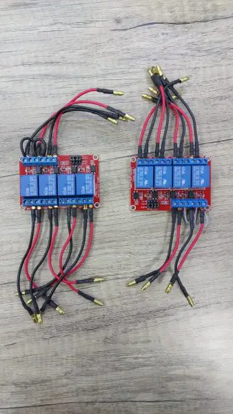

Being said that, using electronic way to bypass the cruise control issues means you can literally use any master cylinder/pump on your prized Tmax.
Attached is the 2 different master cylinder/pump that you can consider:
1. Brembo RCS: Cheap and easy to find, use 19 for right, 16 for left. W
2. Brembo RCS Corsa Corta: slightly more expensive, more setups and adjustments. Can't use mechanical adapter.
The mechanical switch made by Overtake Taiwan is the only product in the market to convert your RCS to work seamlessly with your mechanical brake switches to maintain the function and safety of your cruise control.
Note: be careful during installation due to the small springs and ball bearings.
Electronic module
Using this module, you can literally use any master cylinder/pump.

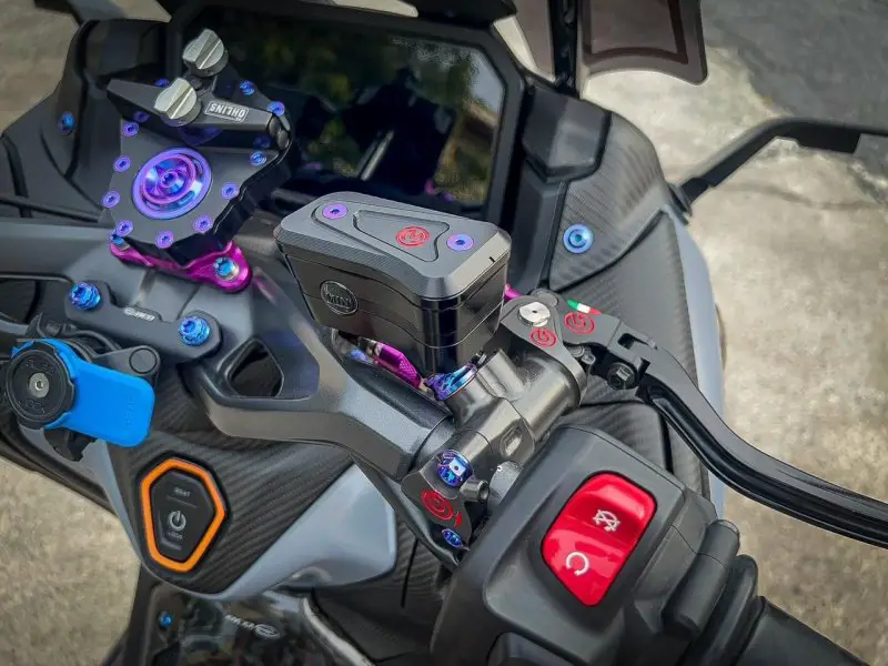

Brake reservoirs
When you changed to aftermarket master cylinder/pump, logically should also pimp up your brake reservoir too.
Look how will the normal boring brake reservoir looked like and compared to the rest below.
rizomareservoir.jpeg.fcb3cd9904582744b5394e833d076031.jpegrizoma2.jpeg.a547f37bb2094d5344f87e1ae5445d94.jpeg
Of course then I advocate the holy grail: Motocorse reservoirs that flawlessly integrate with the RCS without any hose.
thai.thumb.jpeg.4b0f8c63d97164d73d377b7682c6347e.jpegthai1.thumb.jpeg.ecd8fd402b793e02b85d43687192c4c5.jpeg
Now that the 8th Gen Tmax had a naked bar setup from factory makes it easier to modify your master cylinder/pump to aftermarket ones. Despite this, there are still some issues due to mirror relocation, IU location etc. I'll try to explain that in another post.
Do note that you will need to have longer lines when changing to RCS, therefore a good time to change during your brake hose upgrade!
