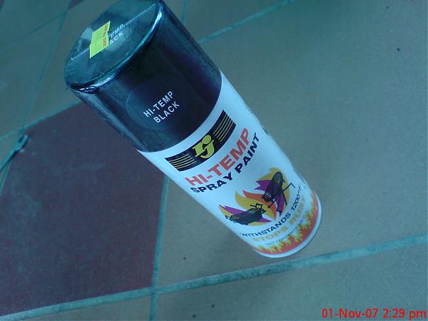

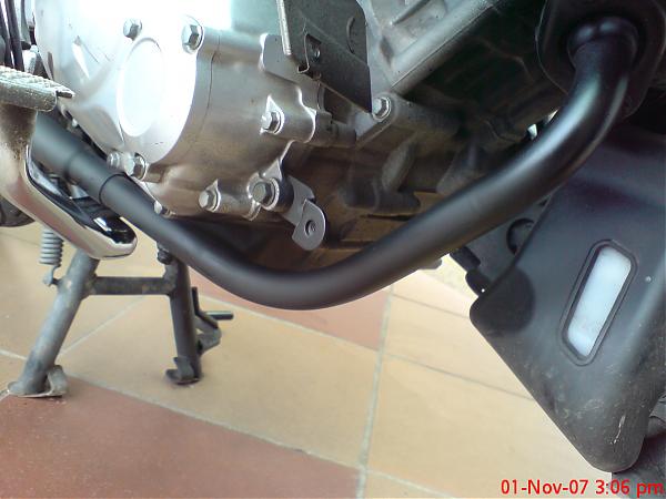

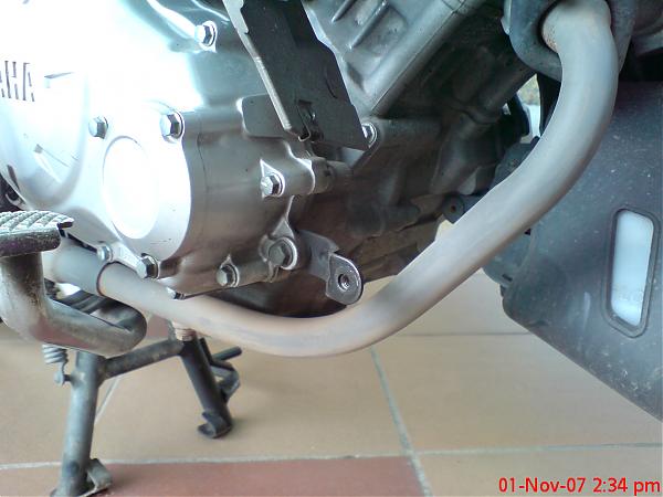

i tink it's best to take out the whole pipe to respray it.
1)sandpaper everything. (i use 100 & 320 course)
use 100 1st coz it's rougher den 320 to fine it.
2)wash the fine rusty flakes away or wipe them away with damp cloth. thinner's the best.
make sure the pipe is smooth n clean. if nt, sandpaper n wash again.
(step 2 is very impt coz i dun read most of u guys clean the pipe after sandpapering it)
3)wipe the pipe with a dry cloth if u're using water. thinner evaporates quicker so dun nd for thinner.
4)once dry, immediately spray hi-temp spray paint to reduce oxidation frm taking place. make sure spray lightly to prevent uneven spray.
(i use rj hi-temp black spray paint to do the job)
5)make sure the 1st layer has completely dried up b4 spraying the 2nd thin layer.
(i only sprayed 2 layers as according to the instructions on the spray bottle coz more layers may cause it to be uneven n "heavy")
6)for best results, leave it to dry for a night b4 fixing ur pipe back.
once u fixed the pipe back, u might notice there may b bubbles forming on the pipe. dat's bcoz u didn't spray lightly n evenly causing thicker areas on some parts.
u might want to call a graffiti fren of yours to help with spraying coz i suppose his spraying technique is well-controlled. make sure he's gd.. haha!!

Here's the pics of my spray tat i bought it from near by hse hardware shop for $8.80 and before and after spray pic. :p
same brand as wat im using.... :cheeky:
