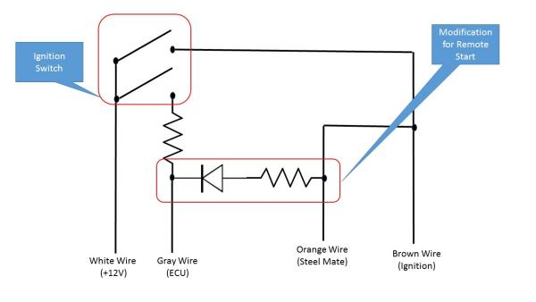

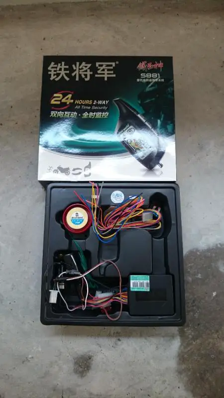

I have installed a SteelMate S881 motorcycle alarm on my bike yesterday. I bought it from TaoBao for $40 and paid $20 to VPost to ship here.
http://www.singaporebikes.com/forums/attachment.php?attachmentid=312908&d=1412777488
I will not post picture of where I wired and place the alarm for the security of my bike.
The connection of Steel Mate
Red - Connects to the Ignition Switch White Wire
Orange - Connects to the Ignition Switch Brown Wire
Black - Connects to bike's frame
Yellow - Connects to the left signal Green Wire
Yellow - Connects to the right signal Gray Wire
Gray - Connects to the crank shaft sensor Yellow/Black Wire
Blue - Connects to the junction box Black/Red Wire
Pink - No need to connect

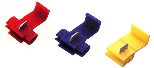

I did not cut the bike wires instead I use scotch lock to splice into the wires
http://www.singaporebikes.com/forums/attachment.php?attachmentid=312910&d=1412777501
Everything works except for the remote start(the starter motor crank but will not start). There is a Gray wire connects to the ECU when the ignition switch key is turned on, I am not sure what signal it sends to the ECU, I need to read further on this wire for the remote start function.
Edit: Read from the web there is a resistor inside the Kawasaki ignition switch on the gray wire to step down the voltage, the ECU once detect this then the ignition will start.
The remote start worked now, I wired a 0.25w 100ohm resistor and 1N4001 diode from the steel mate orange wire to the ignition gray wire.
http://www.singaporebikes.com/forums/attachment.php?attachmentid=312911&d=1412777504
