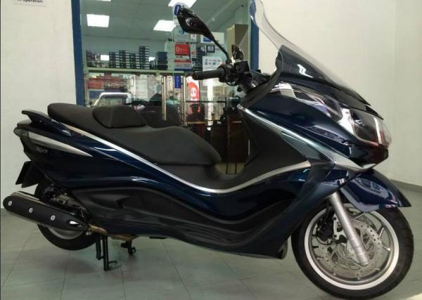

I think ur bike arrived at UM. Saw them posted a photo in their FB....Beautiful maxi scooter!
[ATTACH=CONFIG]304079[/ATTACH]
Yes, I think should be mine. They called me yesterday informing me that I can collect the bike today.

Nice! I think midnight blue is a nice color that's why I got mine in that color too!

Yeah, after collecting the bike, seeing it in front of me, midnight blue is a great colour.
