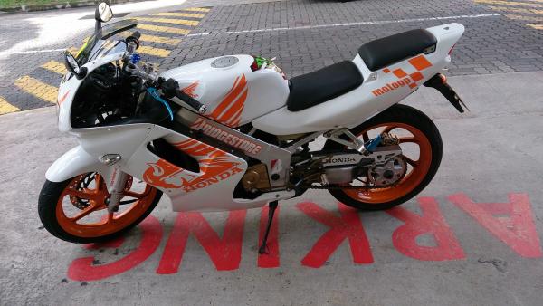

Haha my 1st bike mah, tt y sad lor; but ur rite can use can liao,working condition is more impt. even the mech told me bo hua if u get new. Just being picky bah,the old tachometer is really quite worn out and just feel outta place haha, and cos i think my bike outlook is really pretty good for a 15yr FR bike:), kudos to the prev owner. Hopefully its still the same after few months. I also hope no more prob, pray!:pray:
SP bro/sis in here:bow:, this is xiao di's noobie bike :) pls say hi to me on the road haha. And Wishing ALL An MERRY XMAS! ride safe out there.
