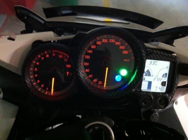

Hi guys.... did any of u encounter this problem before?
i wanted to start my bike but the high beam light appear( but when check it is on the low beam)... when try to start totally cannot..... no crank at all...... but aft 10-15 min later the high beam light disappear n the bike able to start......
[ATTACH=CONFIG]274869[/ATTACH]
Nope. Nvr kena before.
