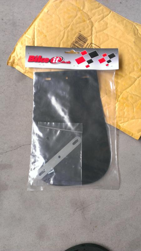

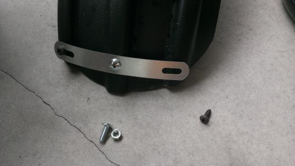

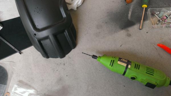

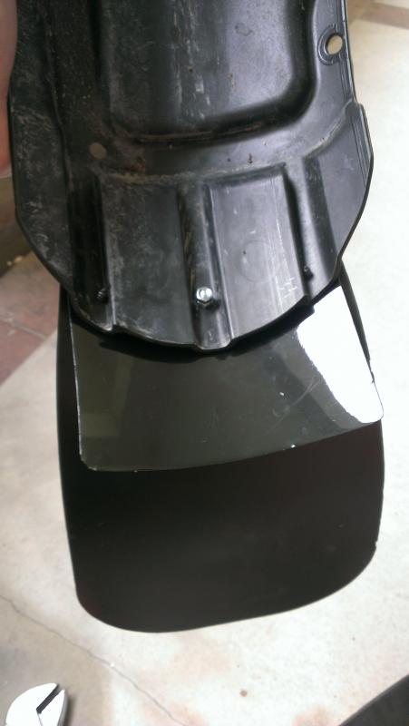

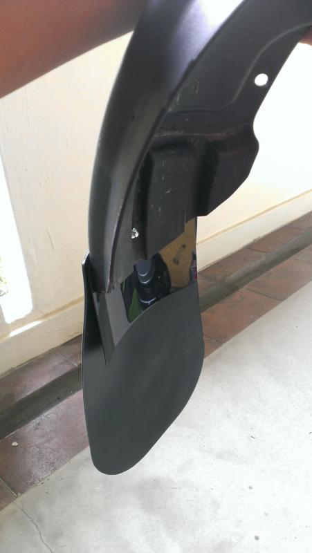

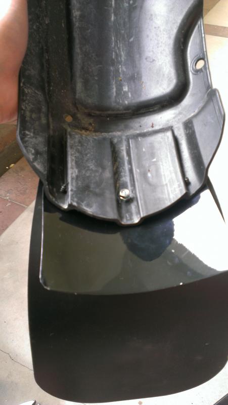

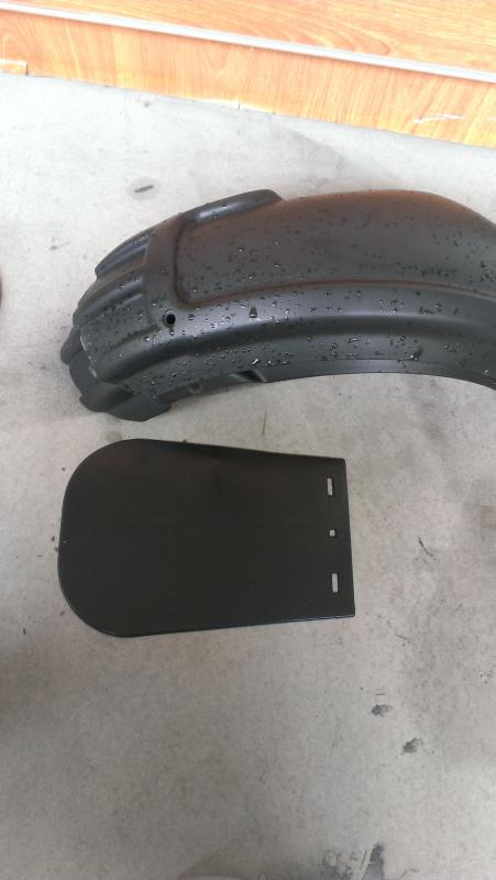

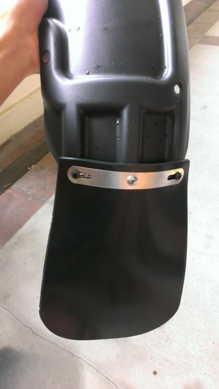

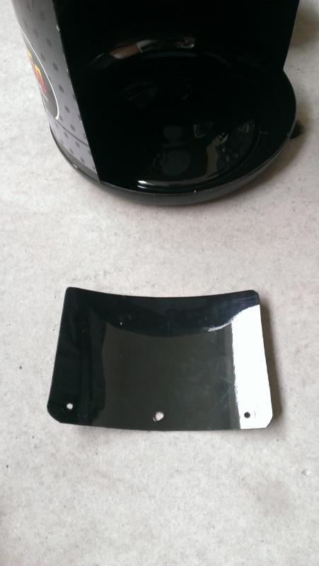

Used a dremel to make holes. Two bolt and nuts were supplied but I only used one for the middle hole and two black screws for the side holes.
Scooter Tuning Is Not A Crime.

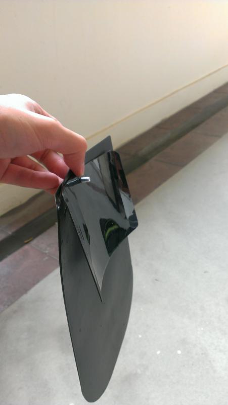

As the flap is made from heavy flexible rubber, I'm worried that it might rub against the tyre. I cut a piece of plastic from an empty bottle to give it some support to keep it from contacting the tyre.
Edited by ben1112
Finished product. Used double locking nut on centre. Just nice the recessed groove keeps the back end of screw and bolt clear from tyre.
Total cost = $30.

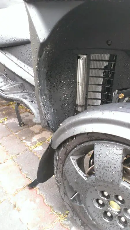

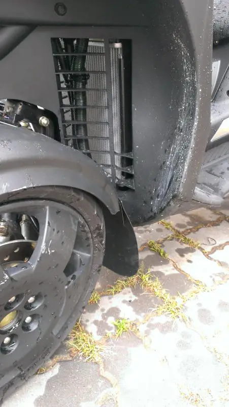

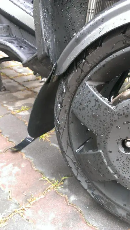

Attached back on the bike. Trimmed the plastic abit more to ensure no interference.
Note: You can see from the muddy water stain that actually water is splashed quite near the edge and will be flung into rider area easily.
