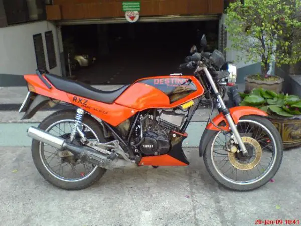

Regarding the sprockets:
Front: Smaller = lower top speed, better pickup, larger = higher top speed, lower pickup
Rear: Smaller = higher top speed, lower pickup, larger = lower top speed, better pickup.
I'm running 16-40 on both my RXZ, top speed Bulldozer 190+ km/h. Bulldozer got enormous torque (can go 6th gear 20 km/h, open throttle and it goes!) and low fuel consumption - doing mostly around 100-110 km/h (5-5.5k rpm) about 3 1/2 liters/100 km. Rev power band starts at 7k rpm - "afterburner" effect, very strong pull that doesn't stop until reach 13,500 rpm, all gears. Using stock Lemang-pipe (no fiber), stock 28mm Mikuni and stock air box/filter.
Destiny (the other RXZ) got Y2 block too but stock (not ported/bored up). Top speed ~140 km/h, very little torque (need to keep above 4k rpm all the time), rev power band from 5.5k to 9k, there is finish. 100% stock engine, carb, air filter/box, 3BS pipe. Didn't measure fuel consumption - haven't done 100 km yet :) But Destiny starts without choke, Bulldozer does not.
Right now both bikes run identical (stock) tyre size 2.75/18 front, 3.00/18 rear. Next week that's gonna change :)
Kind regards....
Thanh
PS trying again to attach latest picture of Destiny....... and works now!

Helooooo everyone, my beauty is back in hand....... Wohooooooo!!!!!!!!!! Let's ride again babe!!!!!!!
Ya.... Looking forward to see what u done to ur bike...
