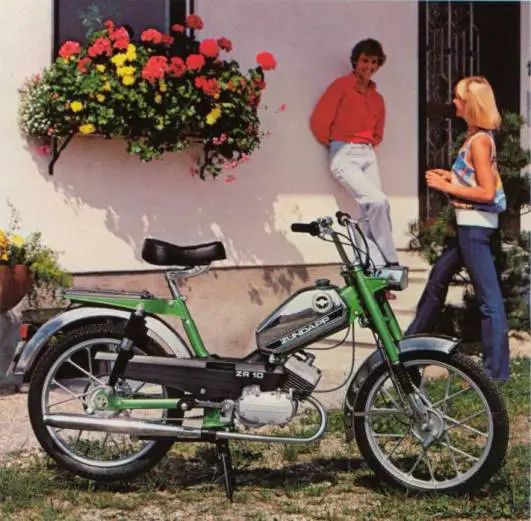

Hi :)
@LoudnessFz
Please have a look at the attached picture...... This vehicle, in Germany known as a "Mofa" (meaning "motoriced bicycle") is designed and build to run 25 km/h. Now, i assure you, running one of those at 90 km/h feels similar to doing approximately 350 km/h on a RXZ - with "sotong" tyres!
"Speed" is always relative to what kind of vehicle you ride/drive - 90 km/h is nothing on a RXZ but on a Mofa it sure is, same as 250 in a Ferrari is nothing but on a RXZ..??

Hi :)
@LoudnessFz
Kind regards.....
Thanh
wow...that sure look like itll fly anytime going any higher than 90km/h..

Which is why the tuned-up ones got this nick name "flying pushbikes" :)
I had one just like the picture i posted, originally an automatic, i planted a two-speed engine which was modified to three-speed, 16 instead of 11 front sprocket, ported block with approximately 7 horsepower (instead of stock 1.5), a 15mm carburetor (stock 10), airbox modified with a number of holes and a pipe from an open (unrestricted) 50cc bike.
As a result it was traveling at slightly over 70 km/h on that thing without generating much attention (it wasn't loud), but at night i hung a "Proma" racing pipe under it and pushed the 100... never breaking that barrier though. I would have broken it had i used one of the then-available 70cc blocks (12-ish horsepower), however it was against my pride - tuners port their own block, not buy a bolt-on kit out of a racing magazine.
Of course the brakes are an issue at such speeds - they are made to stop you safely from 25 km/h, not four times that. Still, it was a challenge, and youngsters today do it just like i did 15 years ago :)
