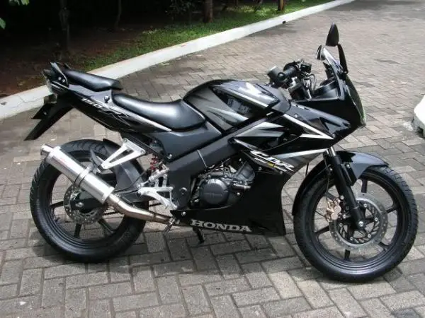

hi guys, im interested in cbr150 (old one)
but i dont see many people selling it. is that bike not popular or not in demand or what?
[ATTACH=CONFIG]249380[/ATTACH]
Most of them COE just renewed... so owners holding on to it first... or the rest are being scrapped... alot of FV,FW plate cbrs. IMO la... its quite a popular bike la...
