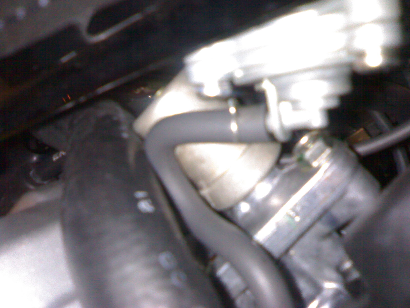

5. next opens up your fuel tank by taking out the fuel line and the vaccum tube which are both on the right side. on the left is the fuel level indicator connector, disconnect it. use a size 12 to open the both at the seat. life up abt 45deg and pull back to take ur full tank out.
6. on the left hand side there is this grey connector that is toward the back of the main frame. that is the connector of the vtec.
7. take the wire with the resistor connect it together with the wiring and plug back the connector. then the shorter led wire connect it to any ground ie chassic find some screw and screw it together for best result.
8. you have done your vtec indicator.
9. to test clutch in and rev. the led shld light up.
cheers to diy.
Guest quizesilver
Originally posted by mloh81@March 30, 2007 11:51 pm
:help: anyone can tell me is this the vetc controller???
yup this is the vtec senoriad (spelling error) not vtec controller.
